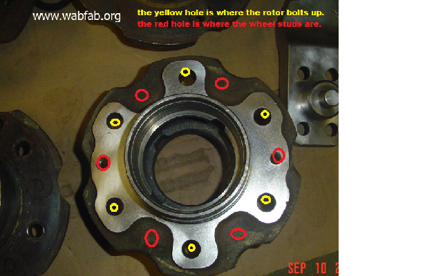

Your rotor is attached to your wheel hub with 6 wheel studs and 2 bolts.
The wheel studs hammer/press in from the back side of the wheel hub through the rotor as you notice the knurled section is in the wheel hub, not the rotor itself.
Back Side of Wheel Hub
Front Side of Wheel Hub
Side View of Wheel Hub
You can hit me up on FB but I don't talk on the phone on the weekend.

My hub looks nothing like that at all. my hub has 12 holes 6 are filled by the wheel studs and the other are to hold the rotor on.

my pictures wont load so i used yours.

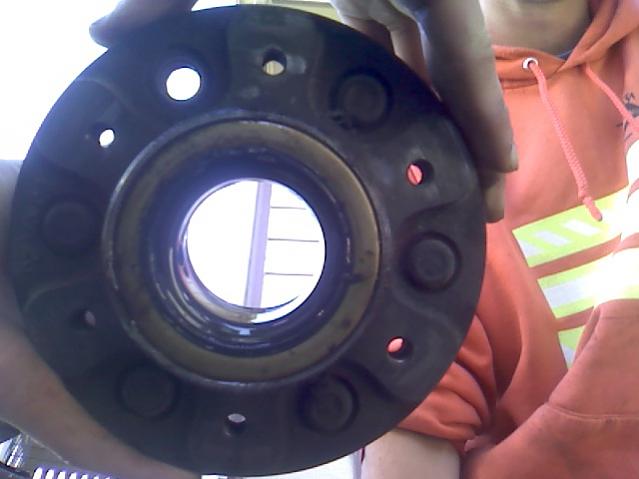

Something is definitely not right.
Did you build this axle yourself?
Is it a mini truck / 4Runner solid front axle?
You sure it is an 83?
You should have 6 wheel studs and 2 bolts. That's it.
Take some pictures. Load to Photobucket. copy the IMG code to here
No way to figure out what you got without seeing it.

the best i can do for a pic. i think its a 83 axle i could be wrong got the truck with the sas in it.

My bet is that is NOT an 83 axle.
Look at the side of the axle tube on the driver's side on the bottom. Any factory truss?
I bet you got one of the weird 79-80 axles with the strange wheel hubs and that is why the rotors don't fit up right.

it has the axle trus on it. my only guess is it has 79 or 80 hubs for some odd reason.
Could it be a IfS hub?

79-80 have no lower truss.
81-83 half a truss
84-85 have full truss
Those are definitely 79-80 wheel hubs and that is your problem.

yea thats what im thinkin. so who sells the hubs? i couldnt find them on your site.

I'm trying to find a pictoral comparison, but that is what I'm thinking. Those are not the 81-85 wheel hubs but a 79-80 set for whatever reason.
Try the "Items Wanted" section here, junkyard, Craiglist.
I know FROR used to carry wheel hubs on their site but don't know now.
