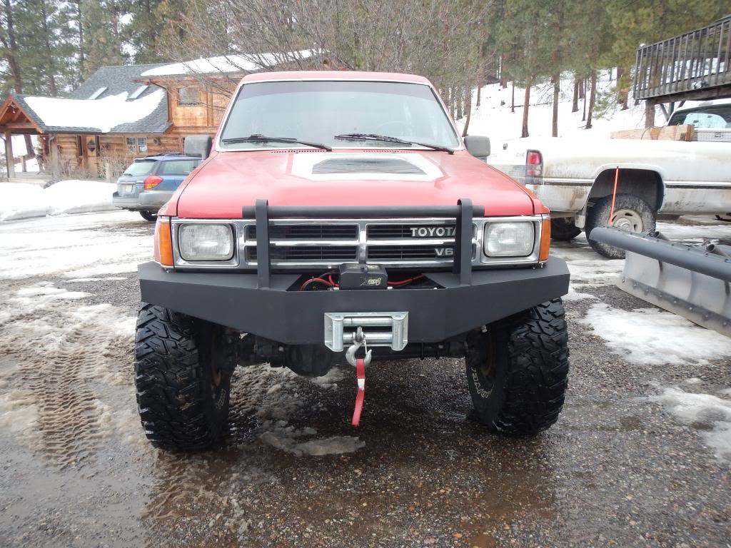

On the 4Runner.

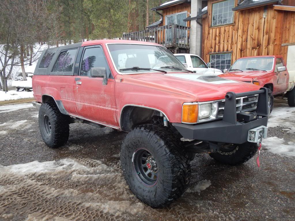

Another view.

Nice! How did you cut your pieces out for the plate bumper? I am looking at a getting a CNC cutter in the near future as all my pieces are cut via out sourced laser cutter currently.

any plans for recovery points?

I like it, turned out sweet! Do you have any plans for bumper cut outs for mounting off road lights? What about turn signals? I added some LED lights to my factory driving light housing and made the lower section of the lens into turn signals in addition to the small ones mounted on on my front bumper, just to make it more visible to traffic from the side view. Nice job, I can't wait to build me one, I'm sick of my Smittybuilt!

This was all remanent steel from CDA Metal's in Missoula, MT. $0.30 per pound and $45 per hour for clipping the steel. The rest was with an angle grinder, right angle square, and a tape measure.

I do have some weld on "D" rings, should have thought about it more before rattle canning it.

Thanks. Probably some day a LED light bar under the tube. Turn signals will be the corner light mod.
They are fun and frustrating to build. I like the look of the '80's Smitty's, but they are non-functional.

The bumper is not finished. There will be head light guards that bend around and down behind the corner lamps. The tube is just 1 3/4", I will slug the inside with 1 1/2", drill holes for rosettes, and fully weld around the tube. The bumper steel ended up weighing in around 60 lbs. The XRC8 weighs 85 lbs. So far into the bumper with the winch included I have under $300.00 into it.
