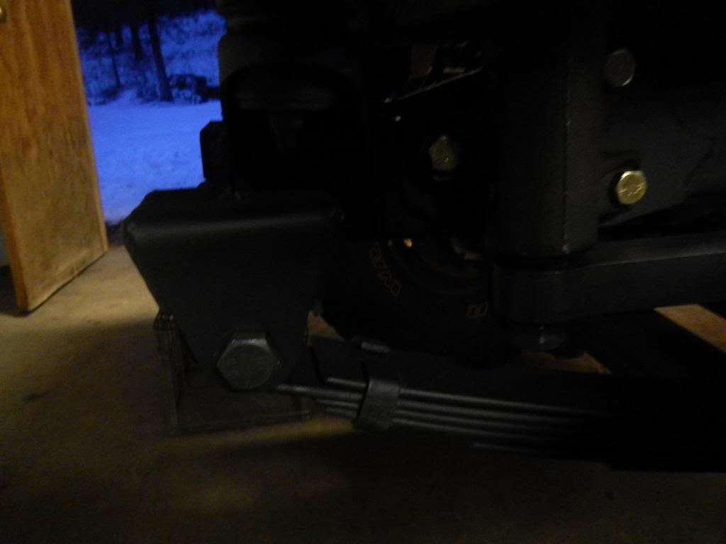

I know you already said hybrid rear pack, but what's your spring pack? I'm assuming it's at least the top couple leafs from your '88 rear pack, so what else? Could I maybe see some pics of your steering box setup, too? Just trying to stay kinda low on mine when I do it, too, so it'd be nice to see how you've done it and if you run into clearance issues. Thanks man, and the ride height looks good so far.
I'll try to remember to bring my camera to the shop tomorrow and take some pictures for you. It consists of the main 88 pack minus the overload with 2 leaves added to the bottom of the pack, and one on top half way for the anti-wrap. This photo was kind of dark sorry.

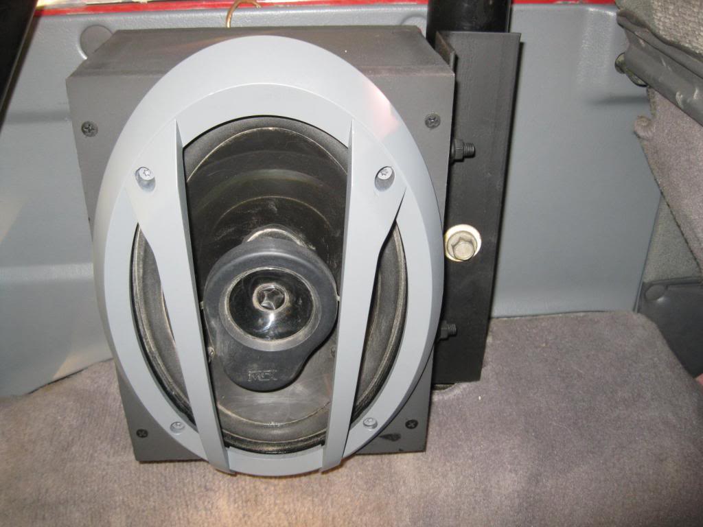

Some speaker boxes for the 6x9's that came with the Runner. Bolted them to the roll bar so they wont get squished.

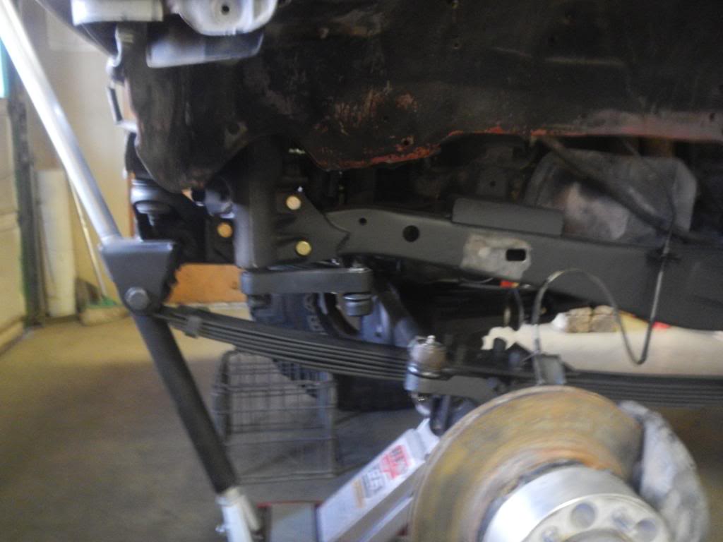

Better close up of the springs, steering box mount, and bump stop. Excuse the used rod ends I'll be ordering some new ones soon. They aren't totally worn out yet.

Another shot of the bump stop mount. One side that welds under the frame arch is taller than the other. Bumps level on the u-bolt plate all said and done.
Another of the front setup before bump stop in place.

how is the steering caster with the pinion angle up that high? or did you cut the tubes and just rotate the diff?
It is a high pinion diff. But i did french the hanger in, so the caster is not too bad.
