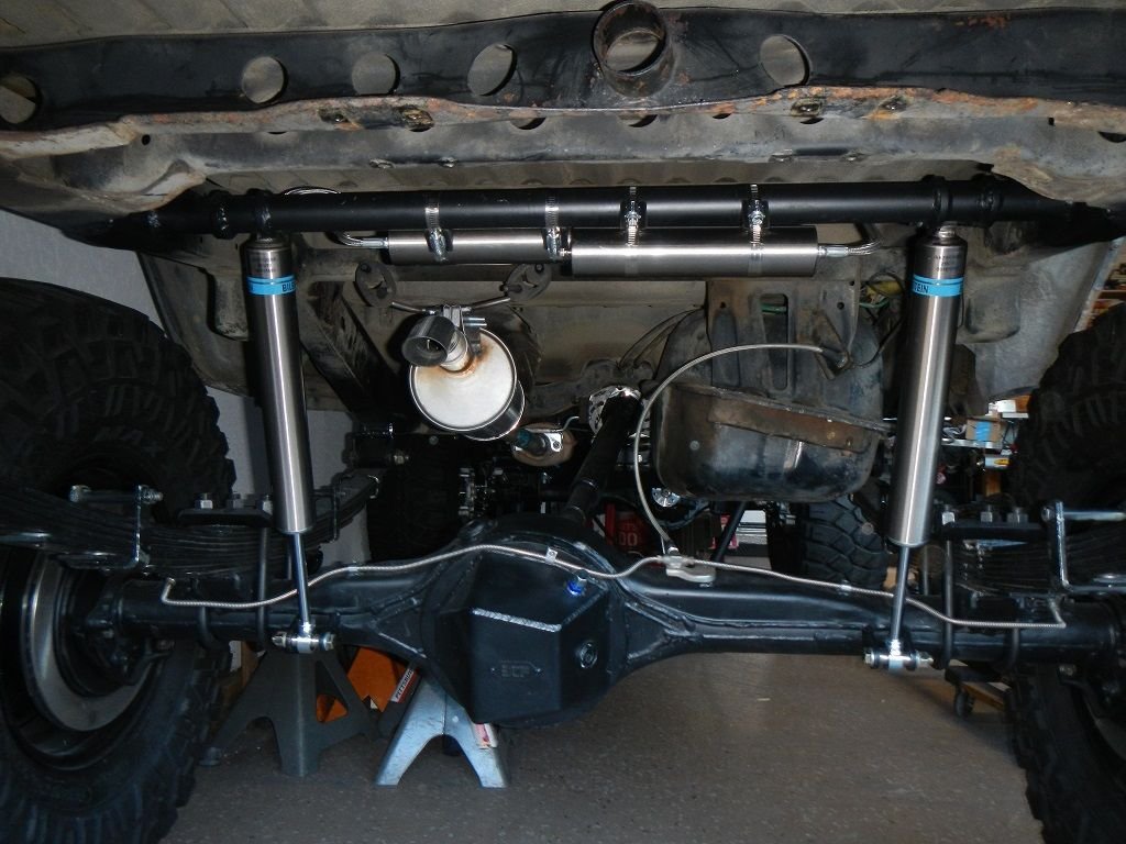

You don't need to replace your rear axle, you can run it with the driveshaft offset. I have an upside-down FZJ80 rear end in my '87 4Runner, I just used a CV driveshaft and pointed the pinion at the output flange. Works great on and off road, I've had it doing 80mph on the freeway, no issues.
