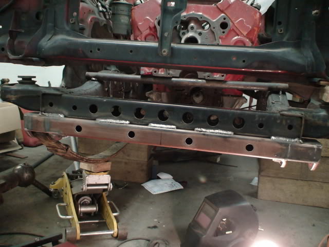

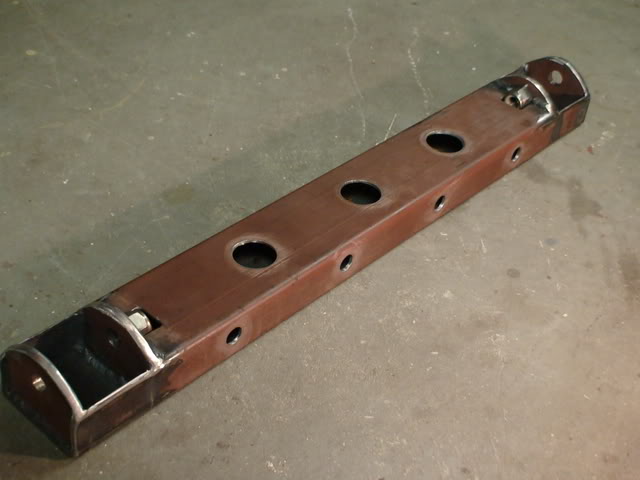

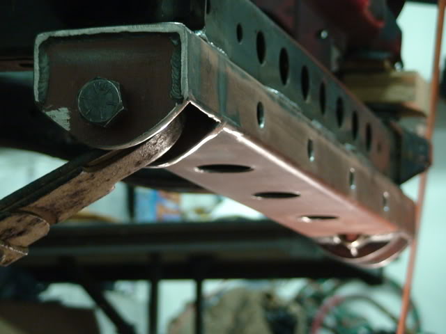

I'm thinking about redoing the front spring hanger to lower her a little more.
Thinking of doing something like this. What do you gusy think?
