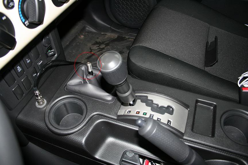

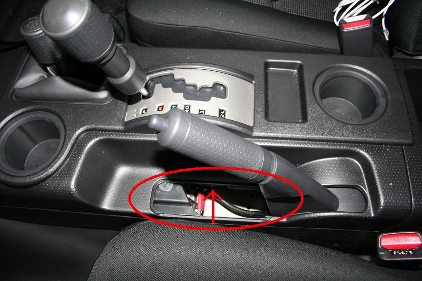

Instead of trying to fish the wires into that location you could do the following to remove the console.
Start by popping of the little piece by the e-brake.

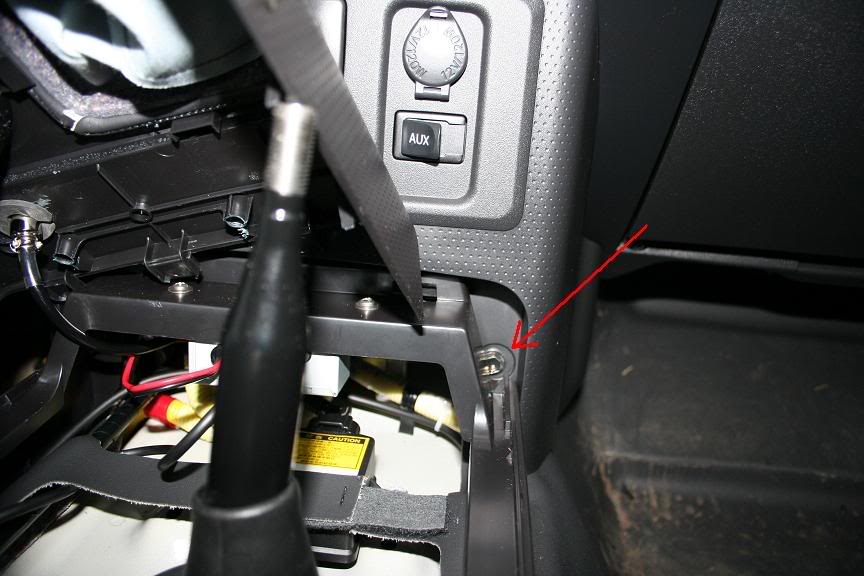

Remove the 4 10mm bolts that hold the lower section in place and jimmy around until you get it out

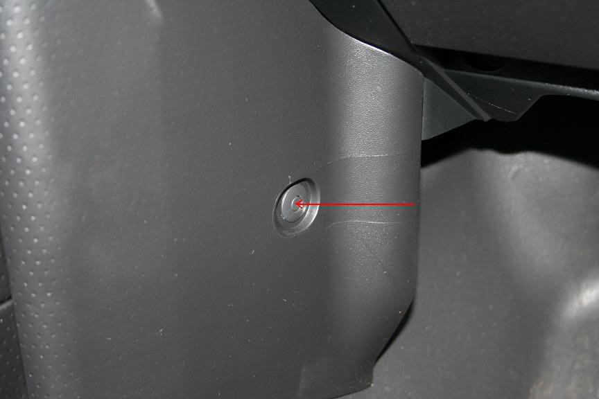

After that is removed there will be 2 more 10mm bolts that hold the center section in below the radio. Since my cb is installed I didn't remove it for these pictures.
Passenger side.
Drivers side
Then pop out the little inserts on both the driver and passenger side. Use something to pop the centers in on them and they come out.

After that the whole center section pulls down and you can get to the inserts and pull any wiring through fairly easily.
Hope it helps.
