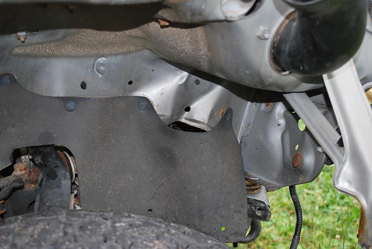

WIfe hit a guard rail post and trashed my 1996 toyota T100. I pulled the pass fender and bumper off and the front part of the frame is tweaked and carnige to the sheet metal under the airbox pushing it up. It's all spot welded metal that is warped and the headlight area is pushed in. Is this thing totaled or can it be pulled back into shape? no collision on this one so it's my pocket. Would like to have a shop get it straight and pulled back then Ill do the assembly stuff. Ill email photos as not working.

if it was mine i would fix it. i have seen vehicles worst than that repaired with home made pullers and a tractor, that are still on the road today.

I see where the body mount is broken (fixable) and the bent sheet metal. The radiator support looks fixable but you can replace it, too.
A shop will always say yes...especially when it comes to money.
Where are you located? Maybe there's a Certifit near you to git aftermarket parts from? You can also use www.car-part.com to find used parts (local or shipped in) fairly easy. You might be able to find someone parting out their T-100 on craigslist as well.

Dont cut it, Pull it.That damage is nothing.Find a small shop with a frame machine and pull it,we do it all day long.
