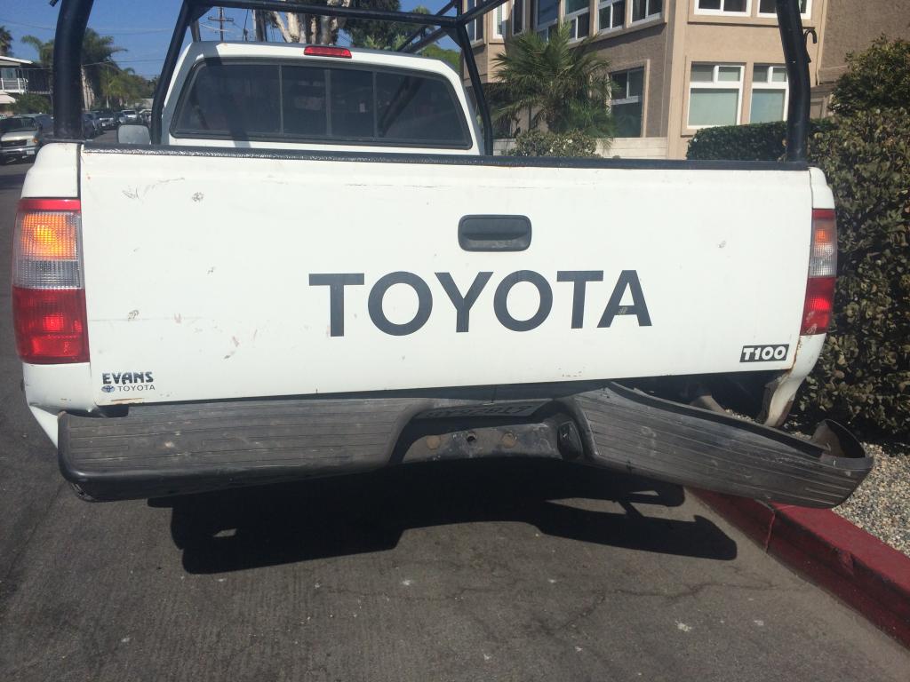

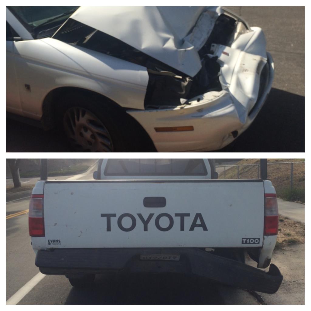

So my truck got smacked pretty good the other day.
I'm okay, truck is driveable but it destroyed the bumper, supports, brackets and smushed the left panel into the tail gate a little.
This is not a perfect truck, its my beater I don't even have collision on it but the driver who hit me was at fault.
I paid $2700 for it.
Their value - $3550
Repair est - $2300 with a $700 Toyota bumper.
Salvage value - $1300
Net to me - $2252.57 to keep the truck as is and deal with it myself. Or I take the $3550 and give it back.
What would you do? I think I can fix it for around a grand with a F150 bumper and use a come along to pull the panel out a little to allow the tailgate to open. This truck has dents all over and doesn't need to be pretty, just functional and safe. Also I just registered and smogged it so I'm good for two years on this thing.

New bumper and some pulling with a winch should easily fix that.
F150 bumper should work, Id buy a junkyard one.

Take the money and run. Like you said, grab a cheapo bumper, find a tree and pull it yourself lol.
Btw, did they total the Saturn? Lol

Yes the Saturn was DOA it was spewing fluids, airbags deployed etc...
The insurance is predicting slight frame damage on mine, I don't know it drives straight and I'm not going to get much better of a truck for $3500 so there we go.

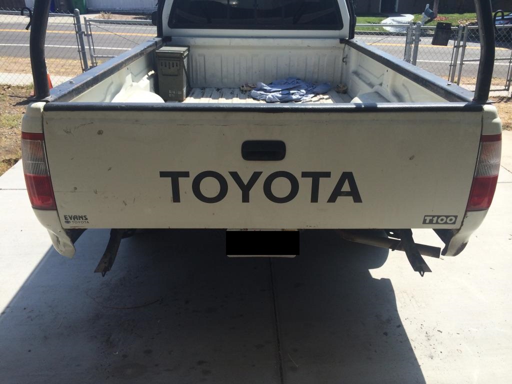

Went to the junk yard found a T100 but the bumper was rusted out. Took the support brackets. Removed mine, hammered the dr side panel to allow the tailgate to open and we're good to go.

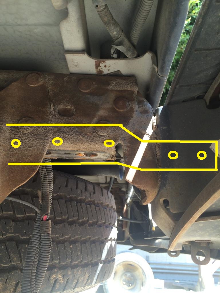

I took a look at a F150 the bumper mounts much differently but I think the trick is drilling new holes to allow the toyota bracket to adapt to the bumper.
Here are some pics, I can't find any write ups so I'm just guessing on this. The yellow is what the factory bracket looks like on the T100

Nope, I was wrong the F150 bumper mounts are about 38" wide the T100 are 48"
are there any write ups on this mod?
