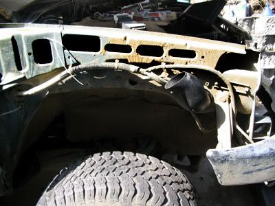

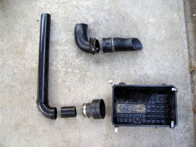

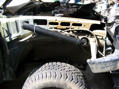

internal snorkel
another option you can do is a cheap internal (fender) snorkel. i have managed to get some water in my airbox so i decided to do that on mine. it raised it up few inches and a foot+ away from the nose. all you gotta do is replace the stock elbow with some pvc pipe. here are some write ups:https://www.yotatech.com/forums/f31/4th-gen-2-more-3rd-gens-internal-snorkel-installed-46043/ http://char.tuiasi.ro/vw/reality/rog...s/Snorkle.html
stock (notice the mud on the inner fender)
