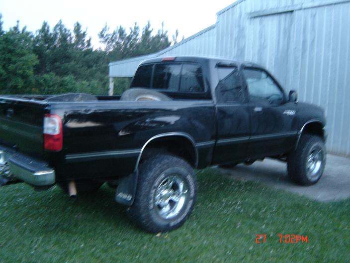

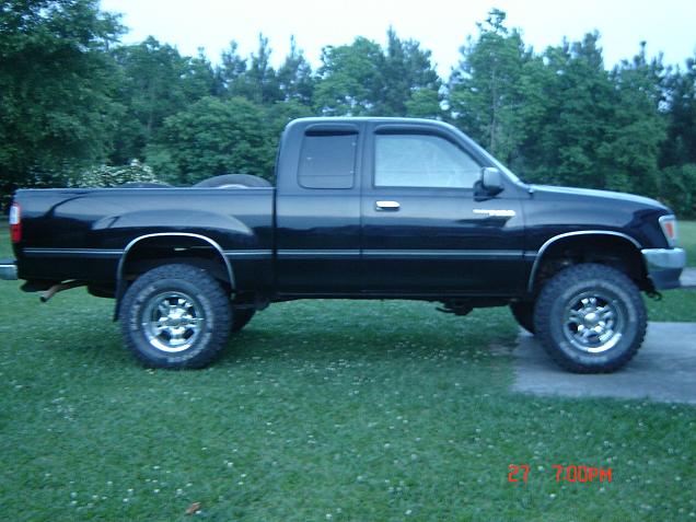

Here is my baby.
Attached Thumbnails Just bought a T100-toyota-003.jpg   Just bought a T100-toyota-006.jpg
Old May 29, 2009 | 11:53 AM
HazMat's Avatar
Joined: Sep 2008
Posts: 478
From: Mechanicsburg, PA
She's a beauty. I've always liked the t100 too. Don't see many of them around here with a lift and beefy tires though. Good find. FYI...Toyota calls for the timing belt and waterpump to be replaced at 90k on the 3.4l. Many have gone much longer with no problems. Just something to think about for peace of mind.
