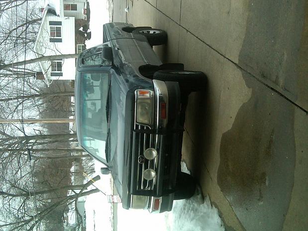

Not sure if you would consider these fog lights or off road lights...

...now the pic should be the right side up!

Fog lights are not the same as off-road or driving lights. Fog lights are designed to be used in fog conditions so the light doesn't scatter off the fog...usually mounted low so it lights up under the fog bank.
Driving lights are used to extend the width and depth of yer current headlights. They are useless in fog conditions.
Off-road lights are usually high wattage and will blind oncoming drivers when used in on-road conditions. These are usually mounted higher than the normal headlights so you git a better angle fer less shadows.
