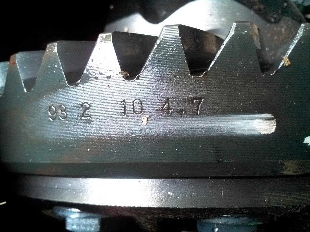

Okay I just bought another parts truck (to satisfy my curiosity about its A04A code) I pulled the diff and no need to count this time-its stamped on the ring gear 4.7

Is that a 8.4 diff? I've never been under a pre 95 T100 to confirm it.

Yes, it is an 8.4- same as later year T100

Yep, those earlier auto 3.0's had 4.7
