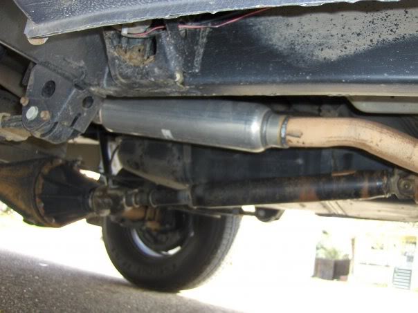

The reason people tell you it will hurt the motor is for two reasons.
First, gutting the cat will cause it to turn on the check engine light. No big deal, if you don't care. It's just the trucks way of saying your polluting, which, since your even contemplating gutting it, you obviously don't care about whether or not you pollute. If you live in a state that does emissions testing, this will also hurt you when you have to do a test. Chances are, you won't pass.
Second though, is that the cat provides some back pressure. An engine needs a little back pressure to run correctly. Removing it will actually hinder performance, and in extreme situations, cause issues like burnt valves.
I would recommend you try replacing just the muffler. Personally, I've got a 24" magnaflow race muffler on mine. Pretty deep, and loud.
