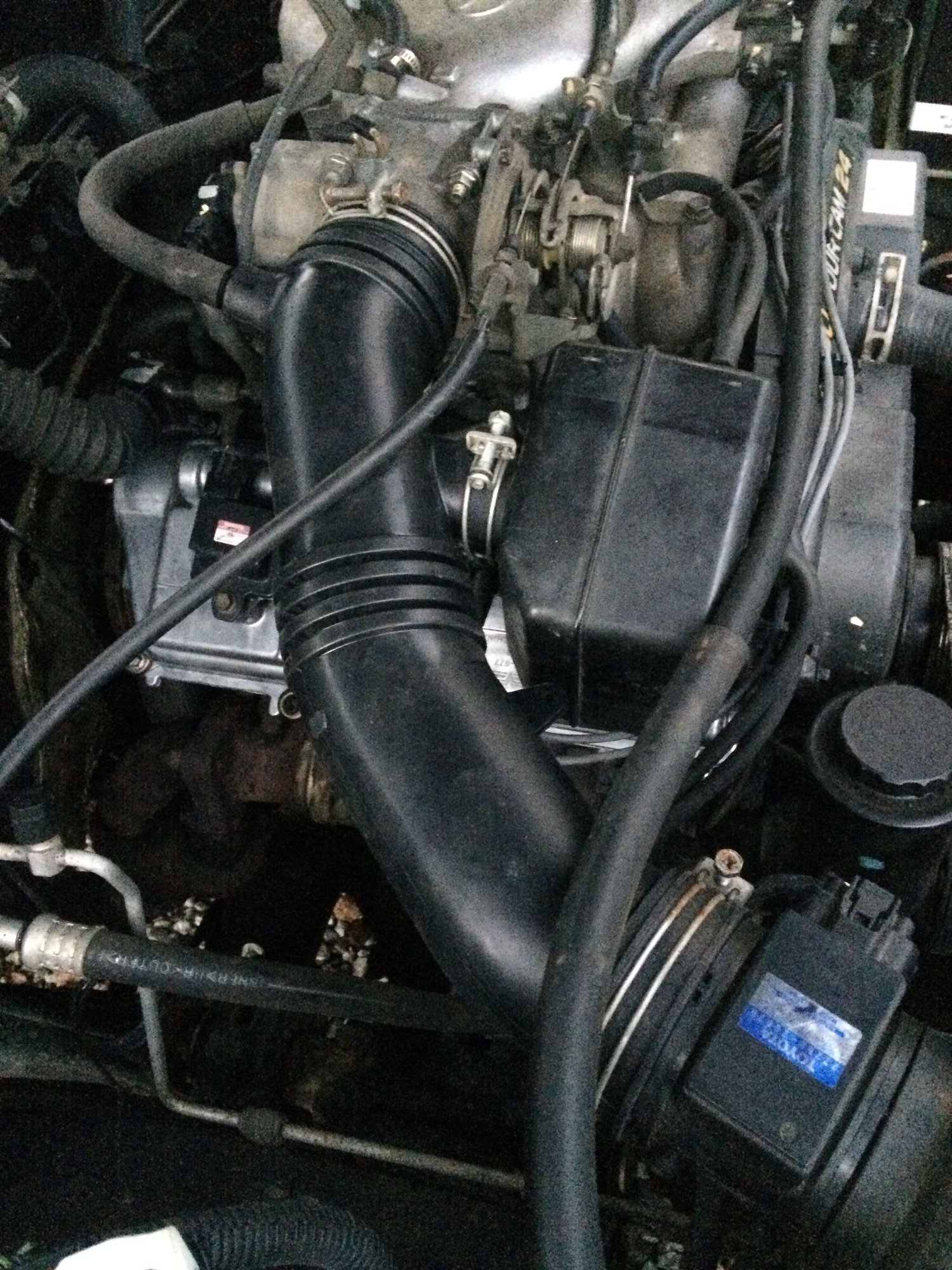

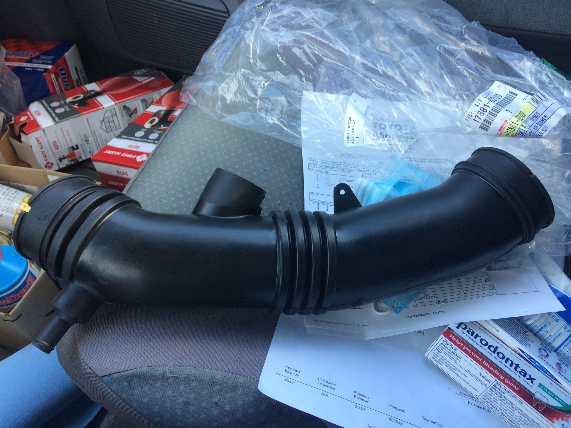

EDIT: 12-28-2020.....After collecting all the seals & gaskets, etc, I removed the valve covers and replaced the valve cover seals, spark plug tube seals and bolt grommets. Also replaced the intake gaskets (2) and the throttle body gasket, PCV grommet & PCV valve. The Right Hand valve cover was found to be cracked in the leaking area (aft, lower corner) so I replaced it with a Dorman p/n 264-977 which fit well and appeared to be of good quality. It came with a gasket/seal and the three tube seals installed. The main air intake hose was pretty hard and had some cracks so I replaced it with Toyota p/n 17881-62120, sourced from the local Toyota dealer.

New air inlet hose installed. You can see part of the new Dorman valve cover in this photo.
New air inlet hose from the Toyota dealer.
Old and New air inlet hoses.
