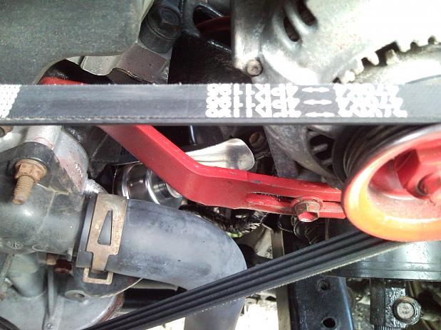

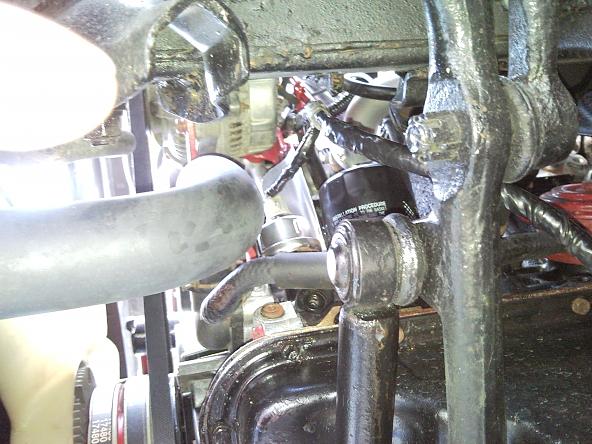

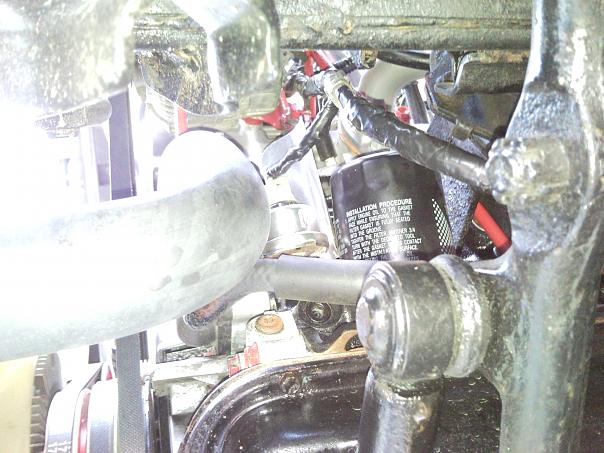

Failing oil pressure heat guard
Ok so here are the pics of the mod, I should have mentioned that I do have an excellent circle ground system installed in the vehicle and it does make all the gauges more accurately. Anyhow here is the pics that I promised and sorry that the quality sucks...
