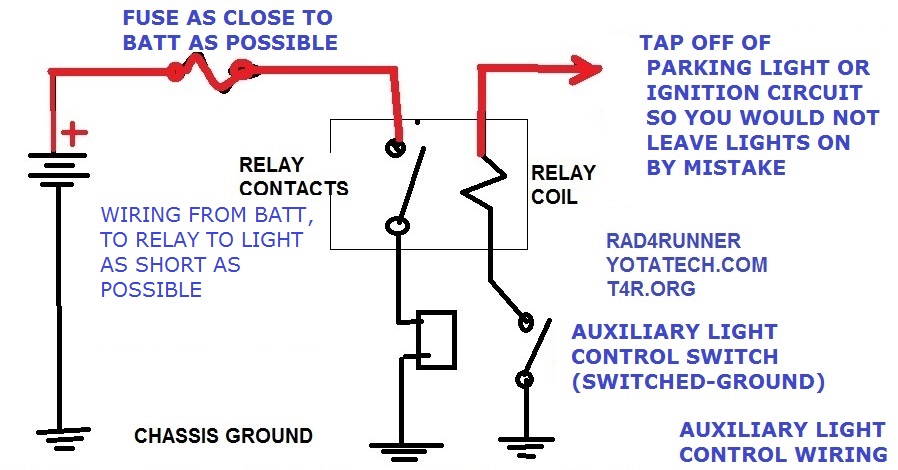

Originally Posted by cobolt23
First, use a relay for the lights. The less power to go the distance the more power at the end. Your switch should be switching very low amprage. Just enough to trigger a relay (250-500ma. Thats .025-.05 of an amp) You can even tap off a fuse that goes on when the truck is running so you don't forget to turn them off and have a dead battery.
Agree on relay.
Best and safest to (wire like below):
  • Use switched-ground control
  • Take load power for the relay directly from battery through a fuse, not from wiring in the cabin. Fuse as close to battery plus as possible. Load wire between battery, fuse, relay and lights as short as possible.
  • Take positive control voltage tapped from marker lights, and
This way:
  • Relay is a close to battery and lights as possible,
  • You will not forget to turn fog lights off (assuming you have light reminder feature),
  • Only the grounding wire runs a long path from relay coil to cabin to your switch. Worst-case that that long wire shorts to ground, you just turn fog lights on.
  • You stay consistent with Toyota's switched-ground control scheme.

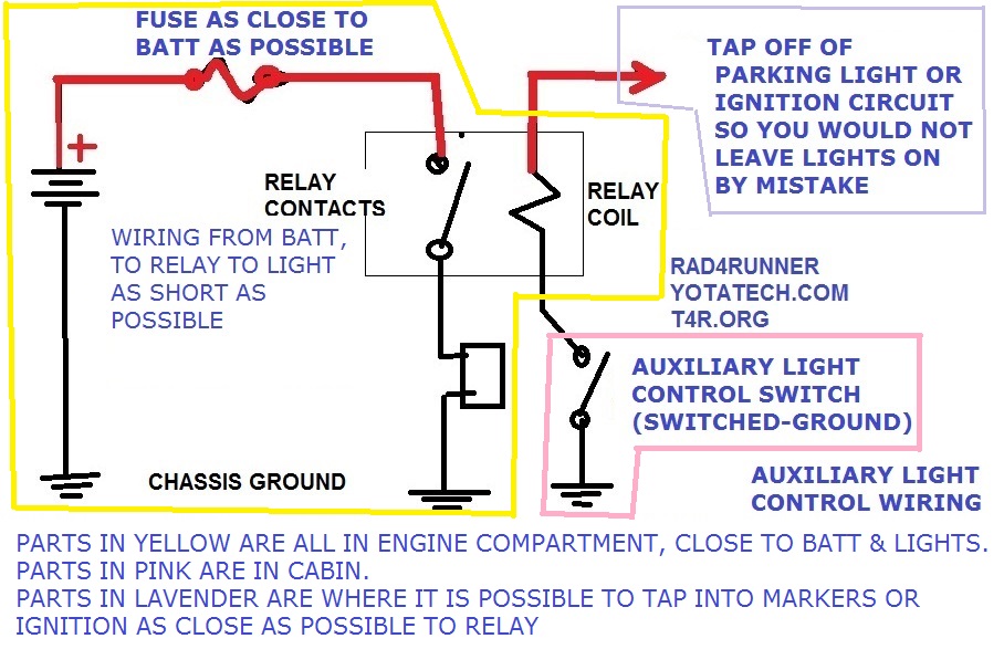

To Clarify Physical Location of parts...

I didn't get a chance to mess with it this afternoon, but there are two relays (one for the driving lights and one for the fog lights) and an inline fuse in the system. I followed the Hella installation instructions on this adventure. Originally the the power source wire was tapped into the battery terminal and then I tried tapping into a fuse. Both of those options resulted in the fuel gauge drop. When I get the drop remedied, I'll definatly opt for tapping into a fuse.

Great info, rad4runner! I'll try to get on it tomorrow with your diagram and tips in hand.
