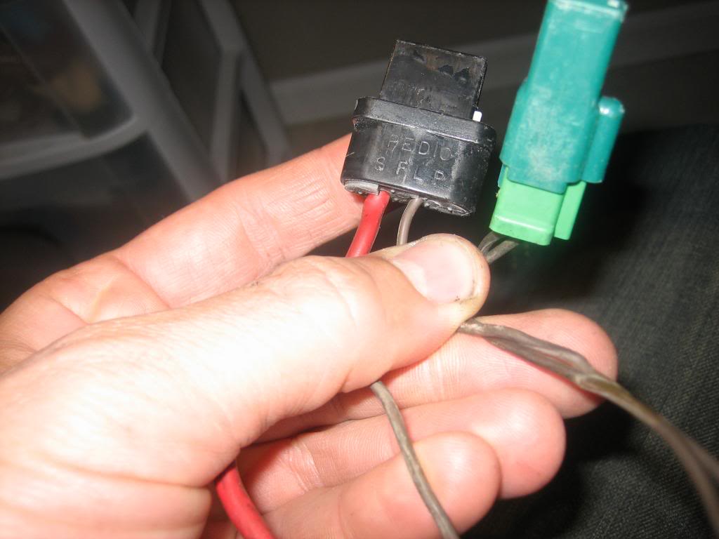

Here is the pigtail that came with the alternator:
S F L P on the plug, but only wires coming from "S" and "L". Inside the plug, there are only metal contacts for those 2 letters as well (even though the female plug on the alt itself has 4 metal prong contacts)
The "L" wire runs into this green plug, and has the same wire coming out again - I am guessing it's some kind of fusible link??

On one of the threads I found was this diagram:
I have "S" (connects to TOYOTA WHITE)
I have "L" (connects to TOYOTA YELLOW)
However I don't have "F" on mine....do I need to do anything or just connect the white and yellows?

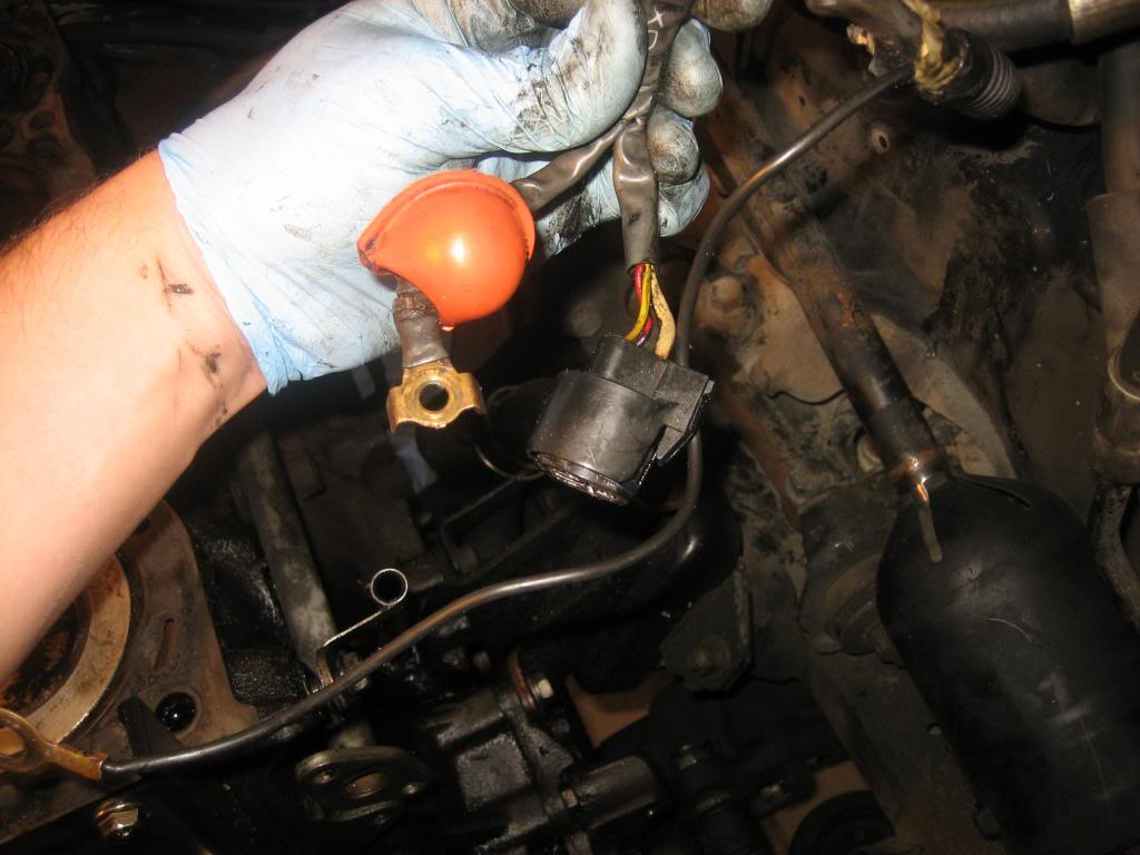

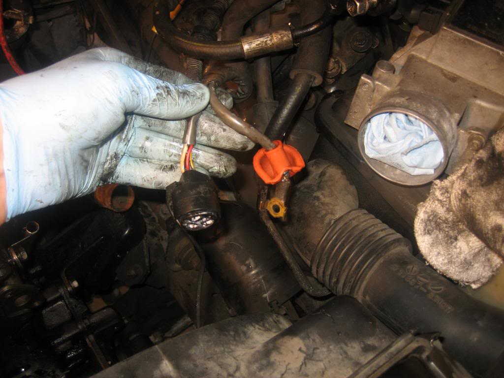

Do I need to disconnect the positive battery return OEM cable since I'm hooking up my own 4 gauge? The current one goes through my fuse box I believe, then to the battery - I believe this is it, with a fusible link in between it and the battery terminal that goes to my starter:
Here is my OEM pigtail with white, yellow, red, and battery return:
