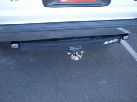

I mounted some auxillary lights on the back as well I initially put them on for auxillary lighting when I go camping...but light up enough for back up lights as well.
They are mounted on the bumper on each side of the hitch. Bought them at cabela's during a sale $14.99 I believe..... Wiring is simple, rocker switch in the cabin....I have a seperate fuse box but they can me wired to the battery.
Attached Thumbnails Hitch-mounted backup lights?-dscn1155.jpg   Hitch-mounted backup lights?-dscn1156.jpg

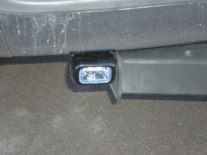

Just wanted to say hello I'm new to the forum and wanted to relay some input on the backup buddy I bought one at a trade show after looking at it and seeing it's quality. I myself think it was well worth the money. It's not one of those cheap plastic things you see out there. this thing was excellent for me while plowing this winter. The utility light feature helped out to while shoveling some of my customers walkways because you can point the lights in any position up down and in and out. I'm actually thinking of buying the towball one to hook my trailer to.Well talk to you later.

They are pics on your truck, right? Just want to see how it looks actually mounted to a truck. I know what they look like off the truck. Or perhaps mounted an in action? Are they bright?

To answer your question are they bright? yes! I do a lot of winding driveways snow plowing and it was like having headlights on the back of my truck. Here's some pics one of them is a little dark I don't know how to shut the flash off so it makes it look darker than it is.

Very nice. I had never seen this post, this sort of thing would be fairly helpful for me, since I often can't see out the back of my truck with the weak backup lights.
