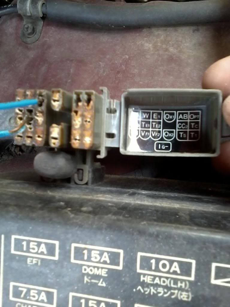

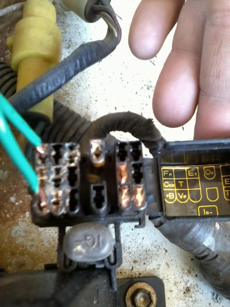

So I bought a great 4x4 1988 Toyota pickup with a replaced 22re, but some of the Wiring I've seen in a couple places is questionable like, for instance a bent up paper clip in the diagnostic port... Should I document the ports it's bridging and replace it after I remove it and something goes wrong? I don't know what to do..

It's in T and E

The T and E is used to set the Timing and is also how you get your Check Engine Light codes. I can not see any reason that they would of left it in trying to bypass some issue. If it had been in the Fp and +B I would say that they were basically energizing the fuel pump full time. Since it is T/E you should be able to remove without any worries.

So I took it out and it's now a tad bit clunky when warm 400 -600 rpm
