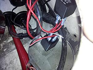

installing the trumpets, a replacement from the old hella's which i guess are now wolo china brand now. compressor installed, relay wired, but when i go tie in to horn switch wire (original) and ground out per directions, horn stay on.
any help appreciated

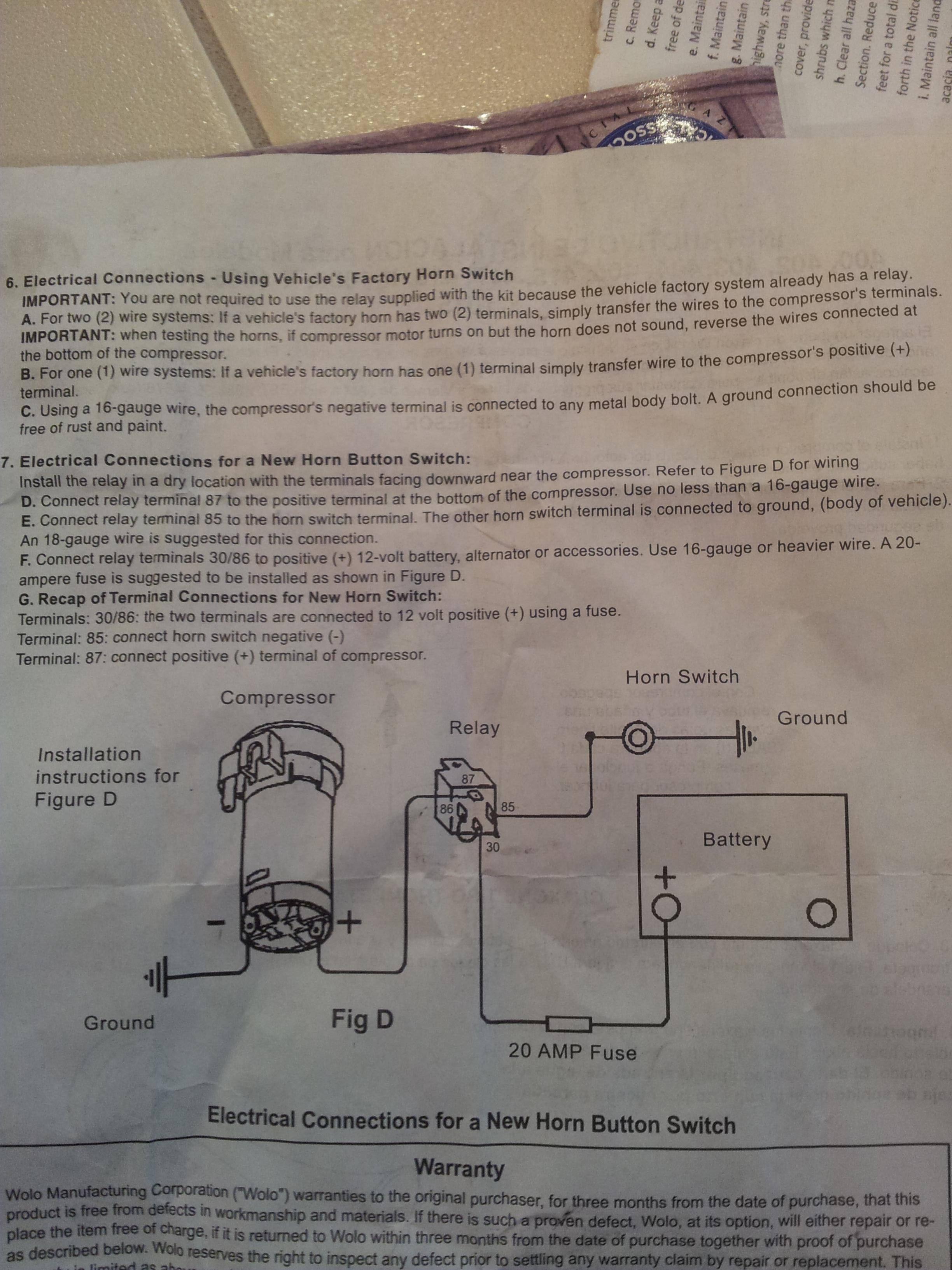

Having no idea what sort of electrical modifications were done to your truck you say you are using the original horn switch.
If it is the factory horn button it says right in your directions you do not need the relay the vehicle all ready has a horn relay
just connect your wires coming off the horn to the compressor as you have one positive and one ground coming off the horn.
This is the set up on all the factory Toyota horns I have. before the nineties
***I looked at the electrical manual for the 92 it appears to have one wire to the horn if yours is the same run that wire to the compressor then the other terminal on the compressor goes to ground.****
press your horn button the compressor powers up.
Good luck.

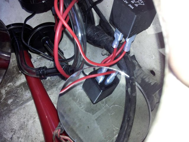

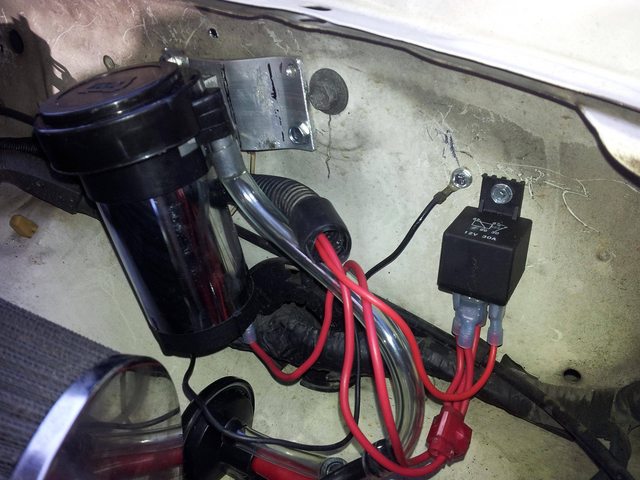

was on the phone trouble shooting the relay, wiring, fuses, and found were the issue was.
instructions say to jump 30 and 86 and groud at horn swith but leaves the relay energized and feeds compressor. identical intall as last time but i had left the horn switch wire grounded also causing a short. horn/hazard fuse was also blown to aggreavate things, but finally done and had i just wired it like i did last time i would have made the 2-3 hour window. doh.
i guess some install WERE meant to be done with a cold one alongside.
Review.
loud
LOUD. testing was tricky as you do not want to be close to these when the go off.
if you have a toyota with a single wire coming from horn switch, that goes get connected to 85 or 86 on the relay, 30 gets power, 87 goes to compressor and ground the 85/86 not going to horn wire. ground compressor and test. yea, the wiring and connections maybe 45min, but the wire wrapping and electrical taping and being 5'5"means i have to walk around the truck 85 times, up and down the step 92times, so that's were most of the time went, that and rippn phatties.
