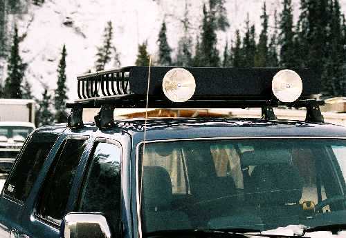

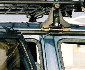

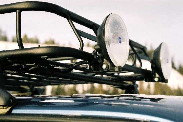

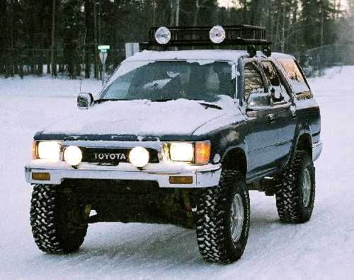

Taking photos is a little harder these days since my digital crapped out on me. Had to take them with the 35mm then get the photos transfered to CD. I also only have the computer at work, which also makes things tricky
Anyhoo, some of you have been wondering what they look like, so here we are!
Attached Thumbnails Hella 500 pics. (w/ where I ran the wires to the roof)-hellafinal.jpg   Hella 500 pics. (w/ where I ran the wires to the roof)-hellaroof2.jpg   Hella 500 pics. (w/ where I ran the wires to the roof)-hellawires.jpg

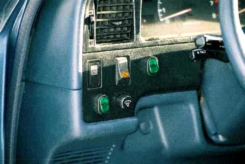

Some more.
The switch on the top right... don't copy me on that location, it's a very bad place to try and put a switch. I spent about an hour just trying to fit it in there.
Attached Thumbnails Hella 500 pics. (w/ where I ran the wires to the roof)-hellaroof.jpg   Hella 500 pics. (w/ where I ran the wires to the roof)-hellaswitch.jpg

Make sure you mount them as far back as you can. I made the mistake of not doing so.
I think I wired them up a total of 3 times
"Yeah, I think that's far enough back... *click* Aw crap!"
Tends to light up the windshield and the dashboard when they are too far forward. You live you learn.

Also, I used the Yakima mounts to mount them onto the rack. My rack isn't Yakima and has smaller bars so I had to modify the mounts a bit to make them fit tight.
I also had to get LONGER BOLTS as the bolts that came with the lights aren't long enough to go through the mounts and out the other side.
