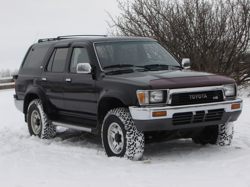

I'm having trouble with the headlights on my '90 4Runner SR5 (canadian version, i.e. daytime running lights). Initially the truck had a set of headlights in it for 10 years+, never burnt out, and on all the time (120K km), just your basic sealed beams (Sylvania's I think). Then they both burnt out within 2 weeks of each other. No problems, just replaced them.
The problem now is that they burn out every 6 months or so, both lights. I've tried multiple brands, (Sylvania, and GE Nighthawks) and it makes no difference. I tested the voltage to them and they're getting 14.5V while engine is running (same as battery while charging).
Does anyone know why this may be happening and/or have a fix for it? Its frustrating to say the least.
Thanks for the input.
