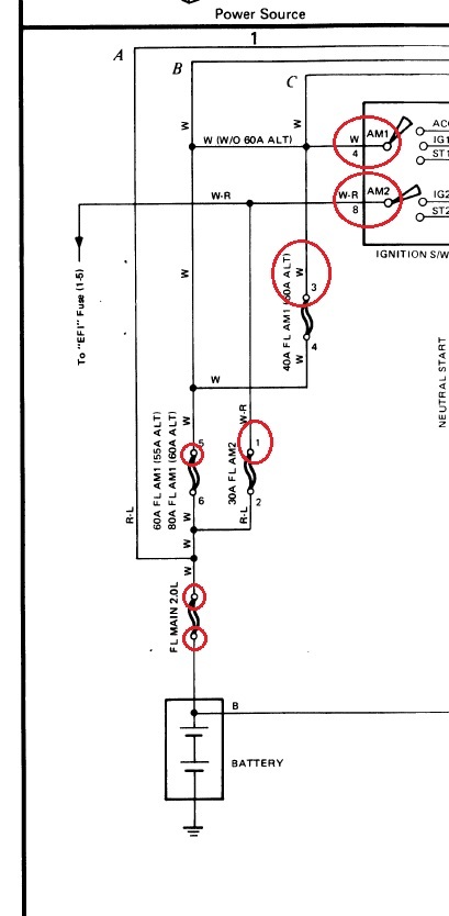

Symptoms suggest either:
1) Bad battery or discharged. A battery may still have thirteen volts IF there is no load. Do you still have 13V when headlights are on?
2) Battery OK but there is high resistance somewhere in the wiring. When current passes through that resistance, it drops the voltage so voltage reaching the parts (starter relay, starter solenoid, clock, radio, buzzer, etc) is no longer high enough.
Start by measuring voltages at points encircled in red below. Positive/red probes to points, negative/black probe to battery negative POST.
IF, and only IF, you have a fully charged battery, they ALL should have around 12V.
When you turn on headlights, ignition On (but engine not started, of course) and AC on, expect voltage to drop to around 11V voltage. If voltage is really low like around 10V or lower, then there is high resistance between that point and the battery positive POST.
Let us know what you find out and we'll go from there.

Schematic of fuse circuit and ignition switch is below. When problem happens, measure voltage at each of the points indicated in orange.
OR take voltage measurements at every point while wiggling cables, fuses, etc. See where you lose voltage when you do that.

So whatever is causing my problems is because of the AM1 plug. It is only reading 1V on the meter. Does that mean something inside my fuse box is bad? All though my ignition and everything else came on and worked great, my starter was still clicking, but like most of these old toyotas its had a history of that.

[QUOTE=4runnerJones;52263596]Alright I feel like I am finally getting somewhere...
Yes. Like I mentioned above, "Looks like either power is not getting to your ignition switch ..." AM1 provides power to IG1 contact of ignition switch.
You should not jump both pins to batt positive at the same time.
Sounds like bad connection inside fuse block OR bad AM1, so let's do this ONE step at a time, properly and thoroughly:
You need to probe EACH of the pins that the 40-Amp fuse sits on, ONE a time.
Pull 40-Amp fuse out.
Multi-meter to Volts DC setting.
Negative probe to batt negative
Positive/red probe to ONE PIN ONLY.
What do you read?_________
Now probe the other pin AND ONLY THAT PIN.
What do you read? _________

Your Dad may have easily damaged the 60A Fusible Link (in green). In order to remove that, you'd have to unscrew it's terminal from below.
Don't worry about the starter for now We already have a good idea what's causing it on first-gen 4runners. Easy to fix PROPERLY, CLEANLY and ROBUSTLY.
Too answer your question everything to continues to work even when the problem starts. However, we figured out that all problems go away when we jumped the two points the 40A green fuse sits on [AM1] to the POS post..

The fusible link is toast.AM1
Pulling it out like that broke it
Needs to be replaced .To trouble shoot this problem more if that does not cure it.
Like Rad said it needs to be unbolted from the bottom side of the fuse block.
It almost looks like it was open in the picture.
From your described problem it would have been the first thing to check at least for me.

Since hazards and headlights are working, I expect voltage on both sides of 80-Amp fusible link. That is IF, and only IF, P.O. did not hack the wiring.
Soo... there seems to be a problem on wiring between 80-Amp FL and the 40-Amp Fuse (AM1). Need to inspect wires nuder the Fuse block. Should be obvious if there is broken or burnt wire.
Disconnect battery before embarking on this journey
