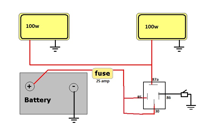

this is how I'd wire it...
Attached Thumbnails Big lights... :P-neg.jpg
x2... i posted an earlier diagram i drew. yours is better
actually, i wired some lights up for swimmerboy, and i used a similar set-up. instead of power being switched to the lights, ground was switched to them, making the entire installation safer. but i don't have a drawing for that off-hand right now. maybe later
