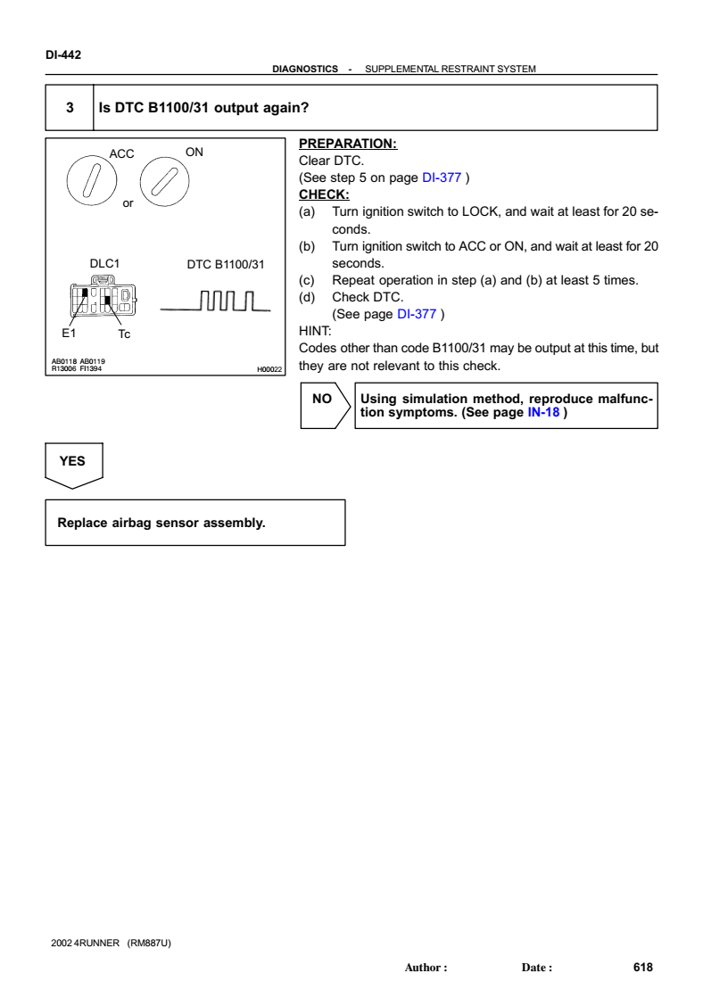

Do you have the Factory Repair Manual for your T100?
I have one for a 2002 4Runner which is similar electronics wise, but may not be exactly the same.
While I almost never suggest just replacing a control module (in this case, the Center Airbag Sensor Assembly), this code is pretty limited to supply power, ground and the Center Airbag Sensor Assembly itself as to what the problems could be.
Below is the test procedure for the 2002 4Runner, which looks similar to the procedure described in a few posts I read for T100s. If I were you, I would want to confirm where the pins IG2 and ACC are located on your T100 before proceeding with the following test!
