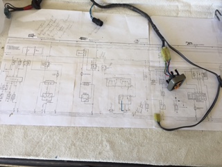

The odd thing is, is that I am getting 12v when i press the up button on the switch on both the driver and passenger switch but i get nothing from the regulator, its like I am having a ground issue somewhere. I have the wiring diagram laid out on my work bench and I have been trying to make my way through it but at this point I'm lost.

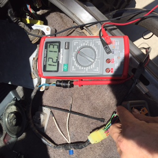

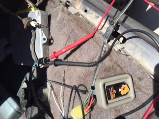

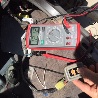

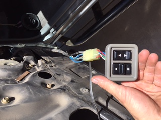

So here is a picture of my passenger door harness pulled out of the door, I pulled it out to get a good look at the wires to make sure there was nothing funny going on. With the test leads hooked up like this I have nothing on my meter.
When I run the my leads to ground off the regulator plug I get 12.13 in the down position.
And I get 12.12 in the up position
Also is this the ground for both windows or just the driver side?

Both windows they ground through the Master switch
Because the polarity changes to reverse the motor
The thing is you have no idea what might have been done before you had the truck .
Your lock switch is in the closed position ?? not that it is open

The schematics your using are for the correct year ??
I can now see a big difference between the 85 and 86 prints
