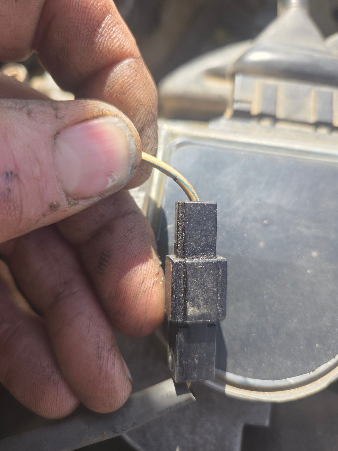

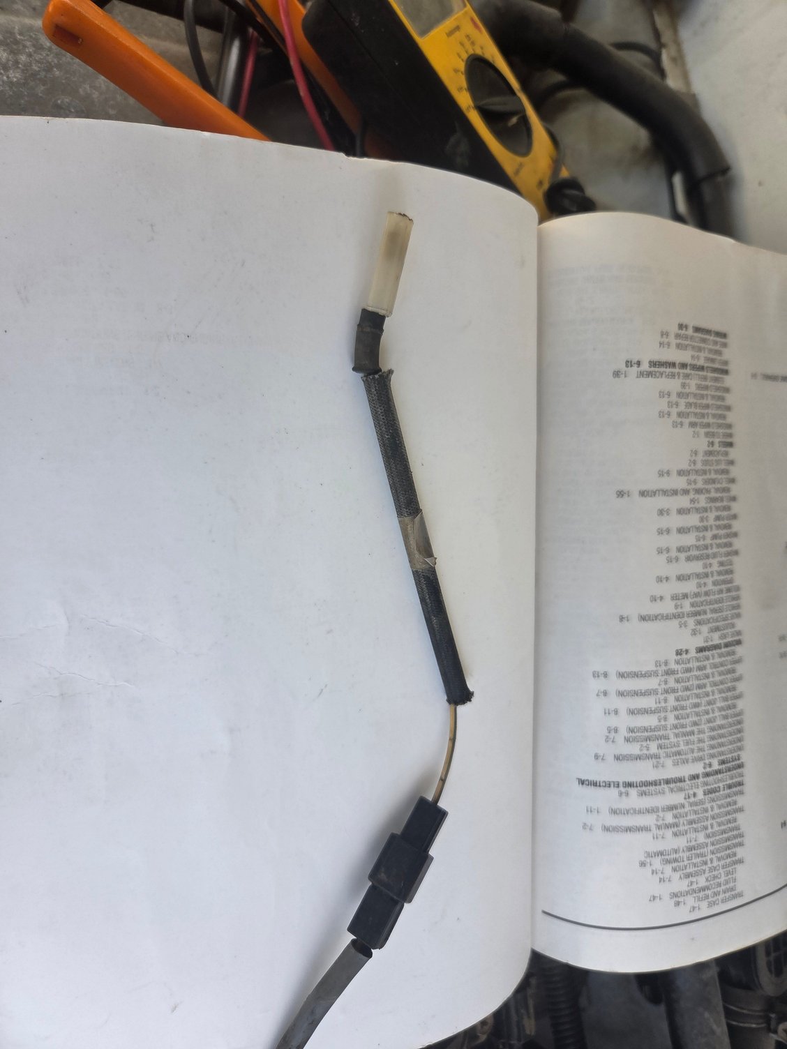

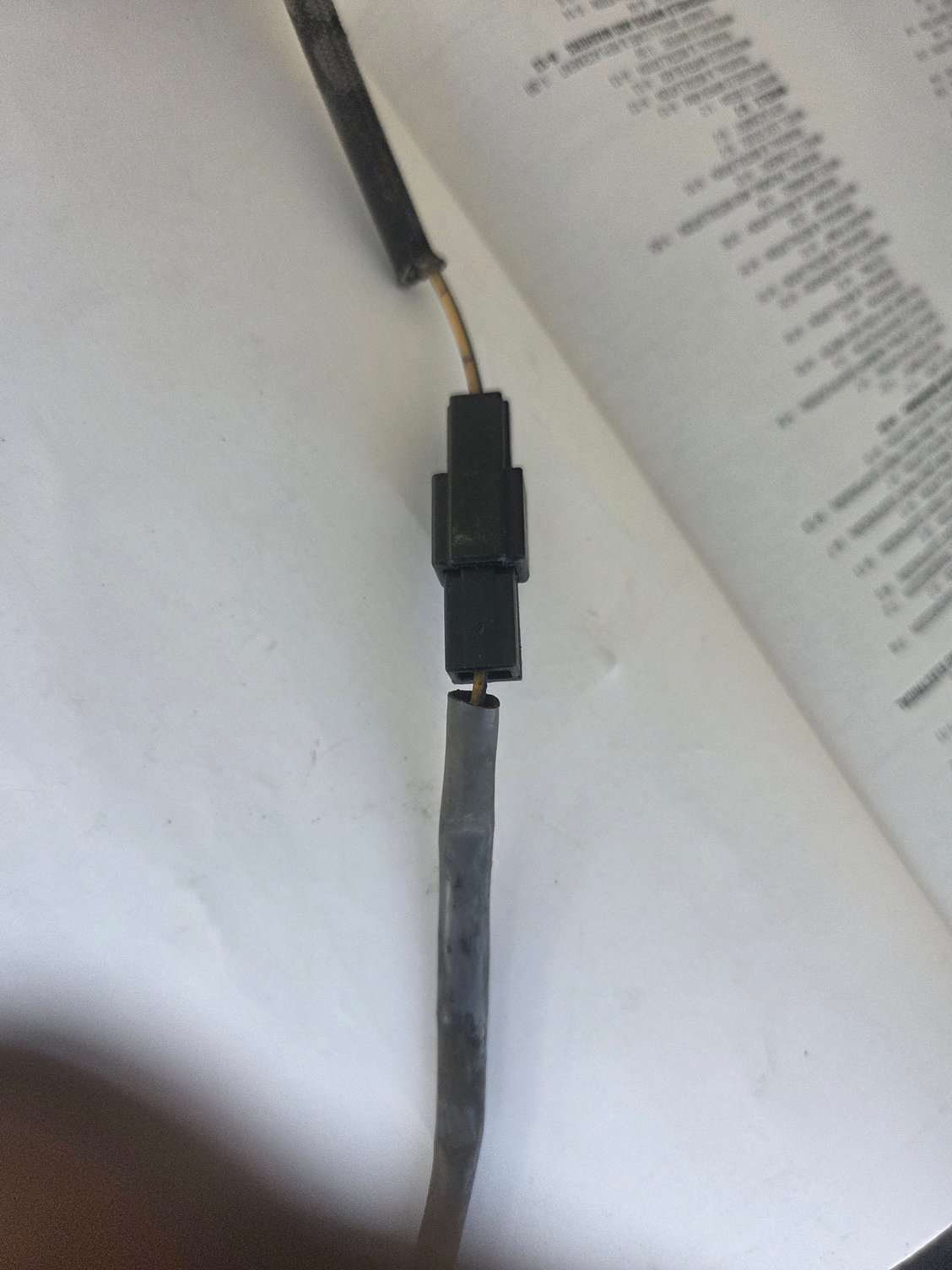

Now I have this wire that's loose and I'm not sure where it comes from if he disconnected it or what but I need to get my truck running if anybody can help me out I appreciate it. I'm sure I'm doing it all wrong and not going through the proper channels because that's how I do everything in life cuz I'm a you know what. So go ahead and say whatever you want to say bad about me I will totally agree with you 100%. No questions asked.

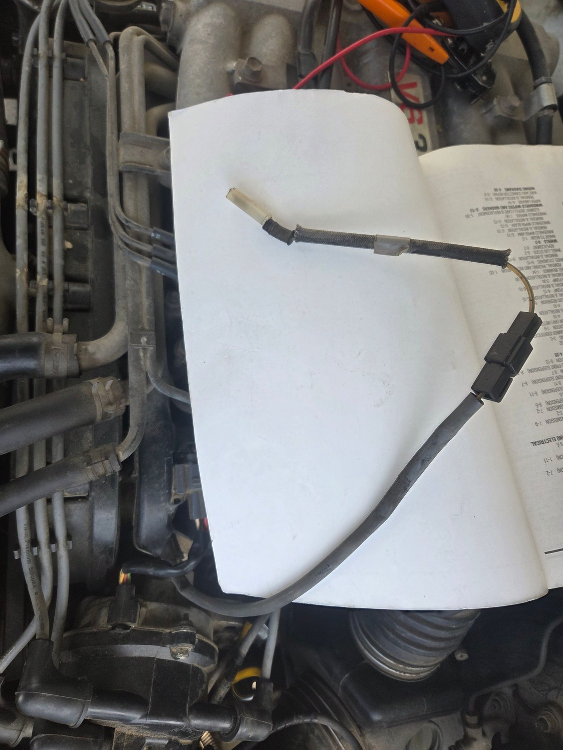

I have this yellow wire with a blue stripe and I'm not sure where it goes it comes out of the fuel rail and it looks like some kind of grounding wire but I have no idea where it connects to I'm hoping that is why my truck's not starting maybe this shady mechanic disconnected it so that he can try and get some more easy money out of me but it didn't work out for him. Now I don't know where he is and I don't know where this wire goes and I can't really afford to pay somebody to fix something somebody sabotaged especially.
Please See the attached pictures hopefully you guys can tell me where it's supposed to be connected to it's a 3vZE 1991 Toyota warrior mini Winnebago but it has Toyota chassis and the t3VZE motor.

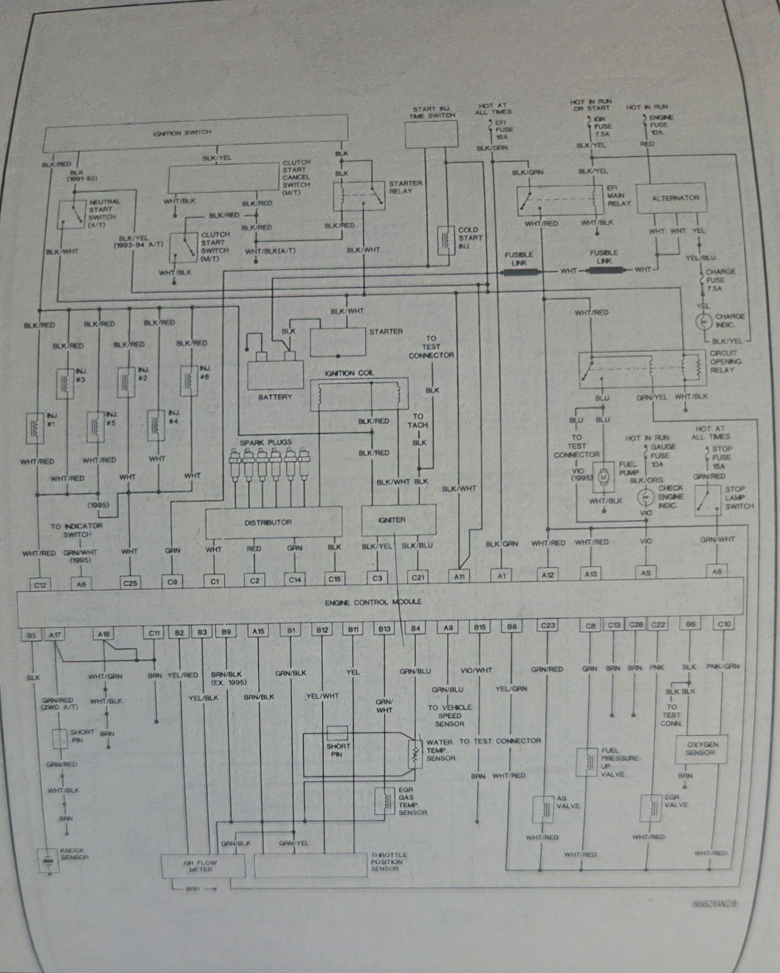

So mainly it is turning over yes does have gas it has a good battery it's not getting a spark I'm pretty sure because this ground wire that's not connected. If not that then it's something to do with the speed sensor 02 sensor because those are on the same circuit I'm not quite sure how it works I know that all of them have the same red and white wire that go to the computer. I'll attach a picture from the book that shows the diagram for the wiring if that can help somebody I don't really understand how to read it very well. I need to read that how to use this manual section in the manual when I can keep focus enough on not watching my back trying to make sure I don't get towed while I'm not looking.

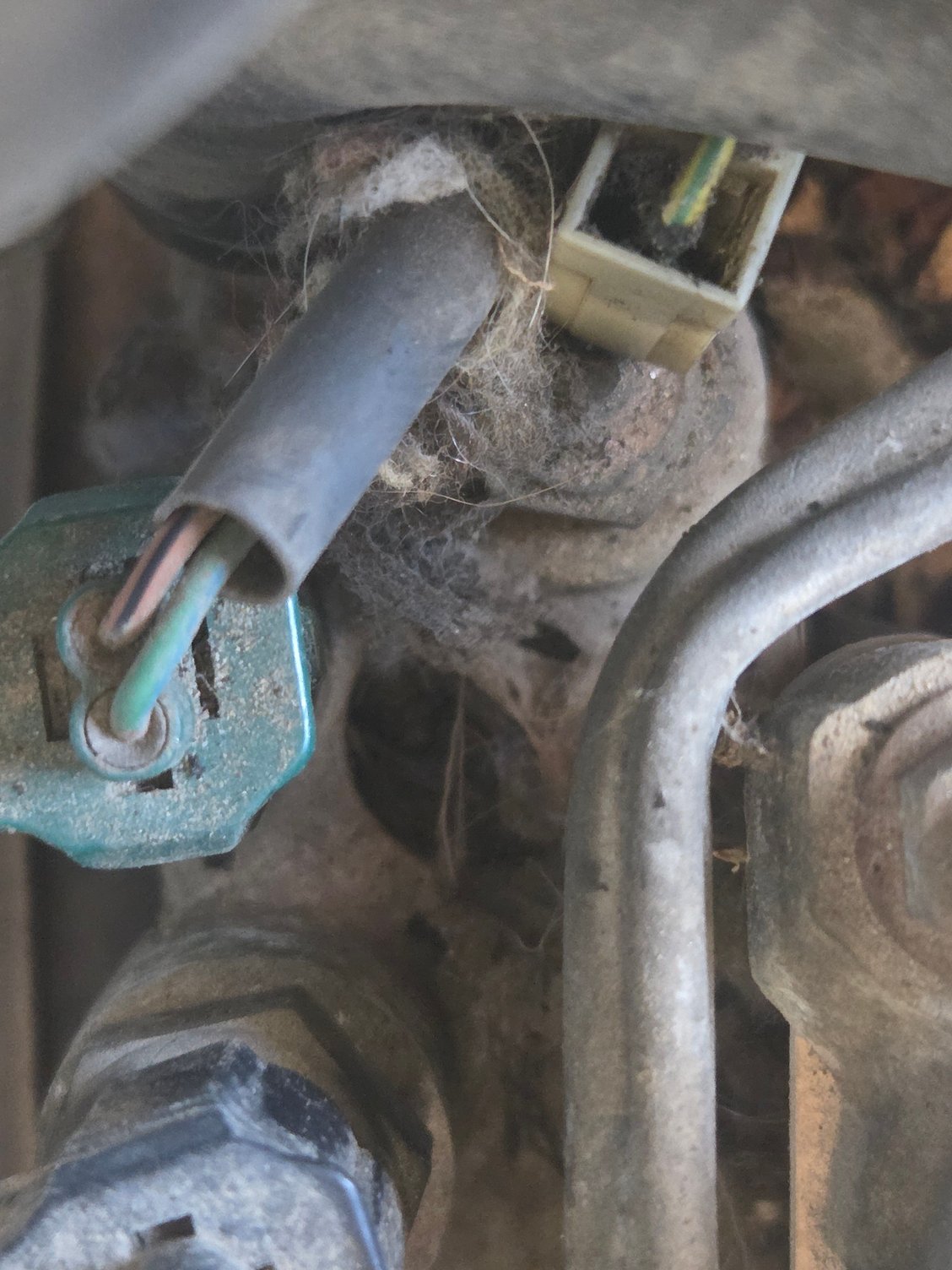

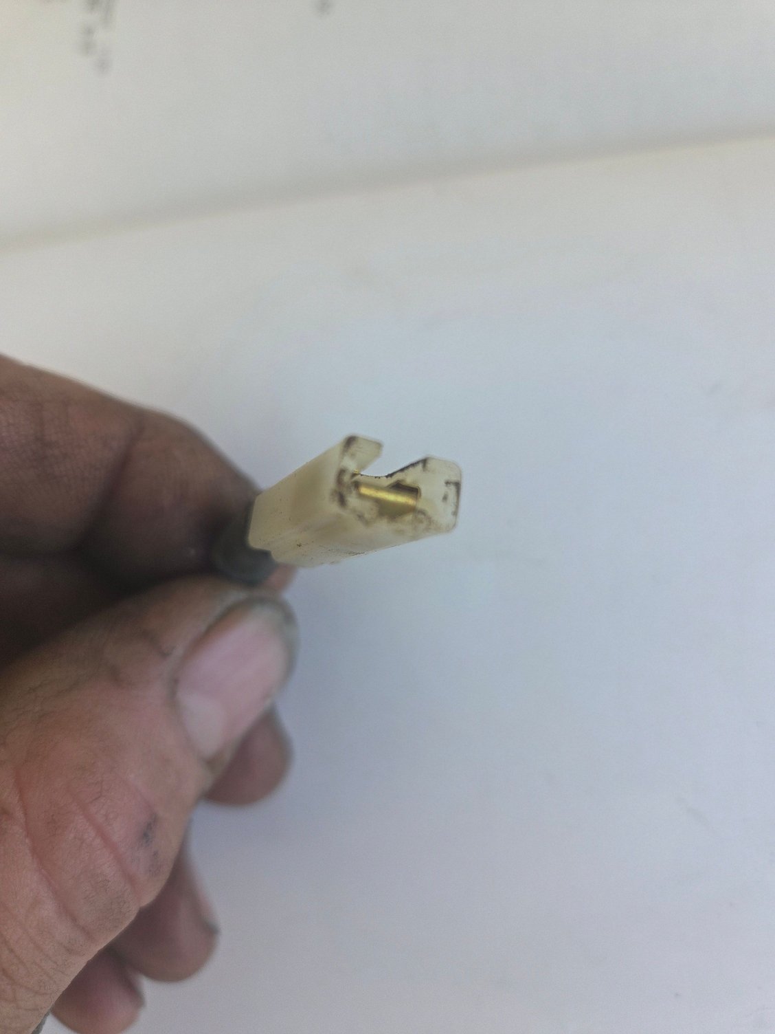

Okay so I traced to where the wire is going and it looks like it's going back right next to the EVAP VSV. It has continuity to the fuel pump as well. And it is powered when the ignition is on and grounded when the ignition is off.
Here's a picture of what it connects to excuse the filth The truck was on a farm for several years before I bought it I still haven't cleaned out the engine compartment I'm concerned about doing that and having something happen where it doesn't run like now.
In the picture you see the evap VSV valve The two pin connector. What I'm trying to find out is what is next to it with the single pin connector with the white housing around it with a yellow blue wire coming out of it. that is the other end of the wire that I'm trying to figure out where it goes.
Any help would be greatly appreciated I'm stranded at the moment
