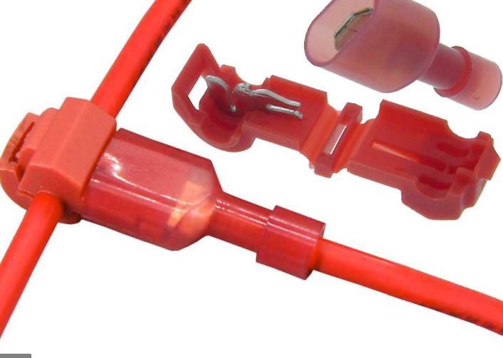

if by T-tap you mean to use one of these, i would recommend against it.
I am not sure how many connections I have fixed over the years because a circuit has been fubar'ed by this type of connector.
might seem like a good idea but in my opinion by the very nature of the device you are cutting several strands of wire and limiting current flow.

Those T-Taps are widely known as vampire splices in the electronics/electrics world. I don't know any of us recommend using them. Instead of a decent splice, you just trash the wire you want to splice into, and after a while, chances are it will start getting intermittent. And THOSE are the biggest PITA to trouble shoot, trust me.

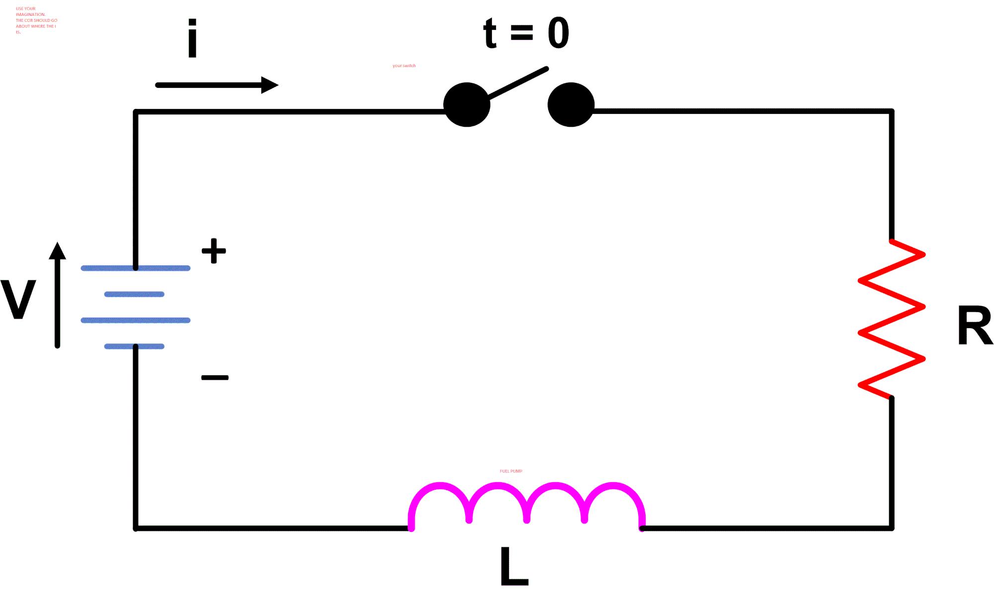

Let me see if I can make a drawing of each kind of circuit. I am a horrible artiste, though. I can't draw a straight line with a ruler...
Series circuit. Use your imagination. The COR would go about where the "I" is, your switch would be where the switch is, ignore the resistor, and the inductor, marked "L" would be the fuel pump. The battery is, well, the battery
When your switch is closed, or ON, the fuel pump can operate normally. When your switch is OFF, no current can get to the pump, so it won't function. Thus no fuel, no engine.
