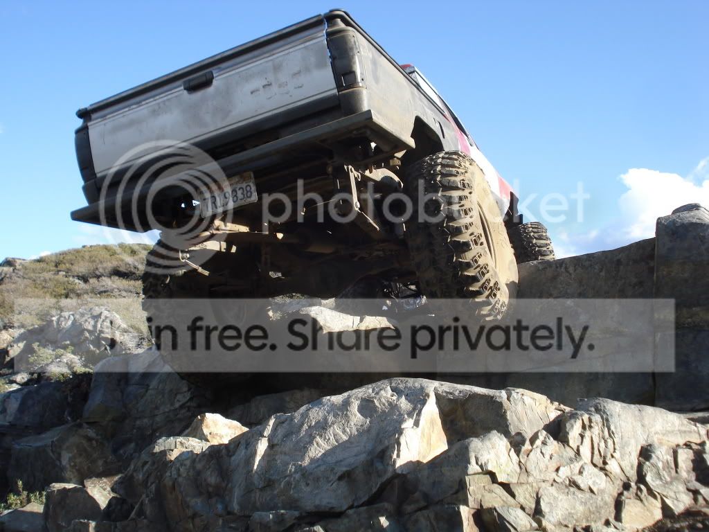

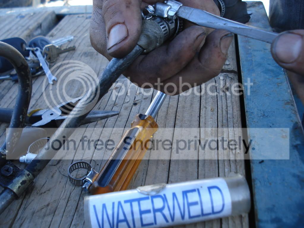

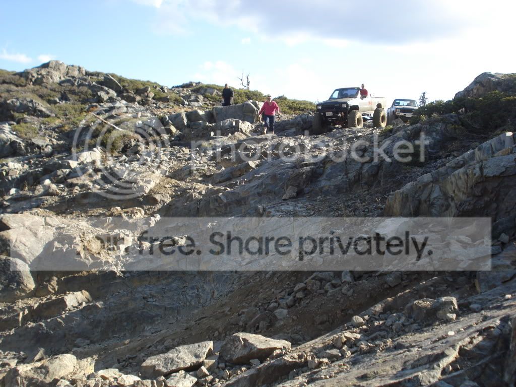

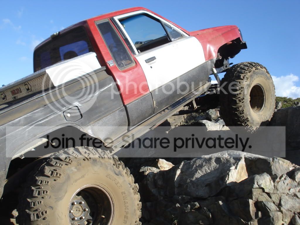

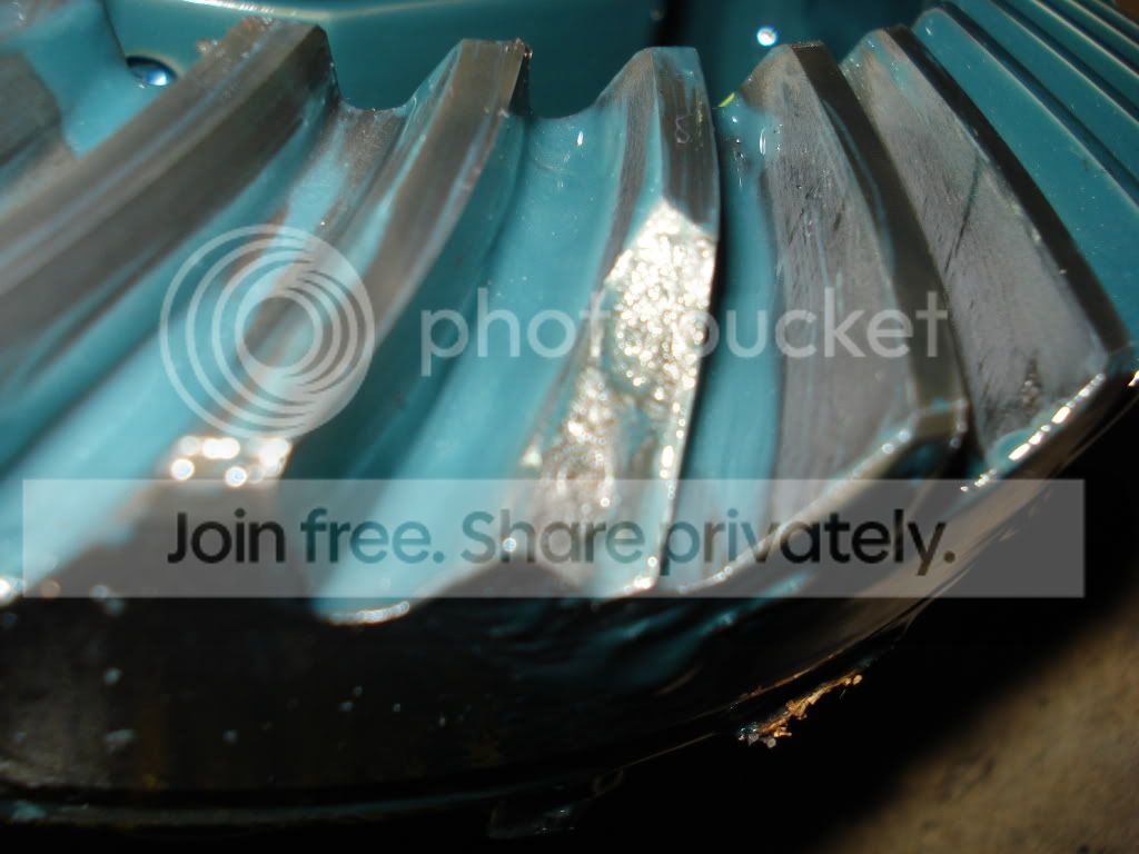

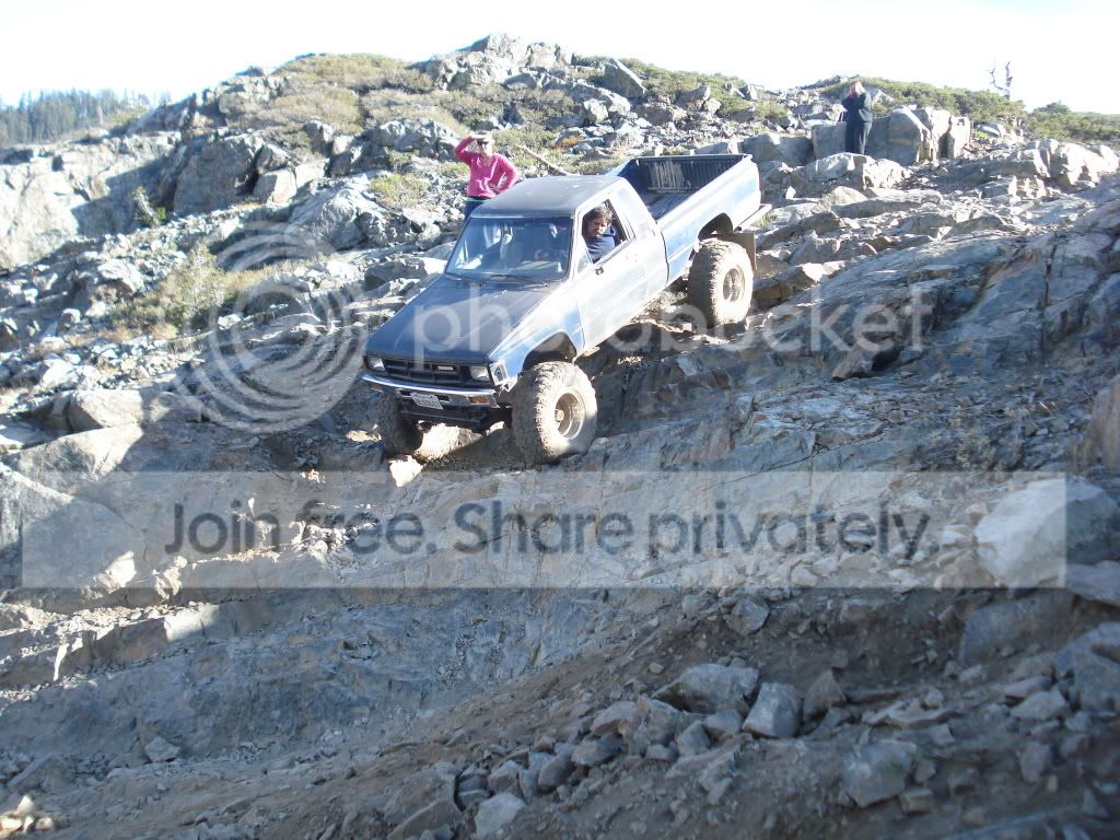

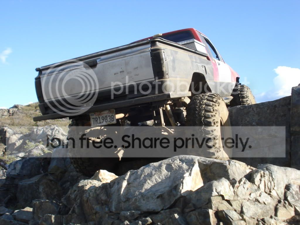

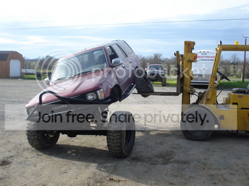

And one last piece of advice, take it or leave it. WHEN you start modifying a vehicle, it WILL start to become a head ache for whatever reason they do. And when that modified vehicle is your daily driver, it sometimes leaves you wondering "am i going to be able to get to work, school, etc...." Sure it doesn't happen to everybody and not right off the bat. But unless you keep with the upkeep, you might regret it. That is why im trying to get rid of mine for something less molested (well one of the reasons)
For example, i have blown up a few diffs, cracked my frame, had electrical problems, let my shackles get loose and get death wobbles, flopped the truck, had the truck not start, etc. BUT I CAN SAY.. MY TRUCK HAS ALWAYS GOTTEN ME HOME... but it possibly couldn't have if i didn't have the mechanical skills to fix it where it had a problem.
I HAVE helped my buddy's fix there trucks quite a few times; broken axles, blown beads, blown hydro assist lines, broken knuckle studs, broken shock mounts, broken etc.. etc.. etc.
But when you start doing like this, things are going to start breaking. (and i just feel like whoring this thread with my own pictures,
Then things like this start to happen.....
Oh and youll notice your truck starts to slowly (or quickly) getting MOre and MORE beat up. lol
Look how clean it was at first.

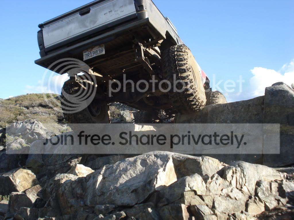

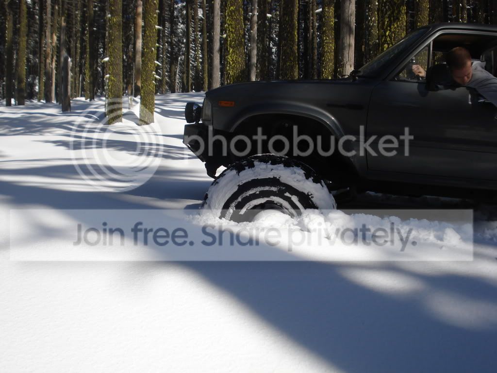

With that being said. I got it bone stock, wheeled it for a little, then put a 4" ifs lift on it and a rear locker, and within half a year a straight axle was under it. I HATED that damn ifs lift, and id recommend not putting on on there, you can get to all the wheeling spots up in the highlakes stock. We did it a bunch, and i just like building my truck, thats why its how it is.
For cheapness, throw a locker in there and a small lift if you want. I sort of rubbed with 33's on my ifs lift.. so its going to depend, the nice thing about the straight axle is being able to move your axle forward, (well along with the added articulation)
this is with that 4" lift and 33x12.50's
Id say with a 1-2" lift and some hammering you could probably get some 33x12.50's fine. or you can search for some 33x10.50's. I like 12.50's though.
