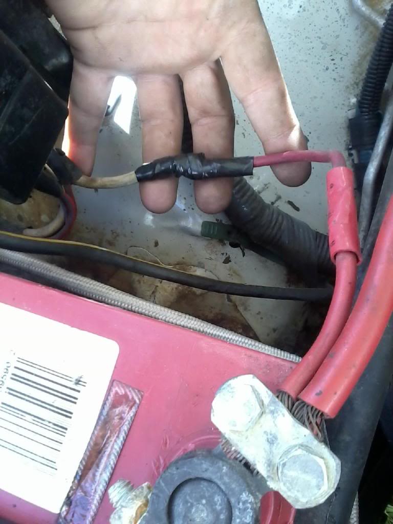

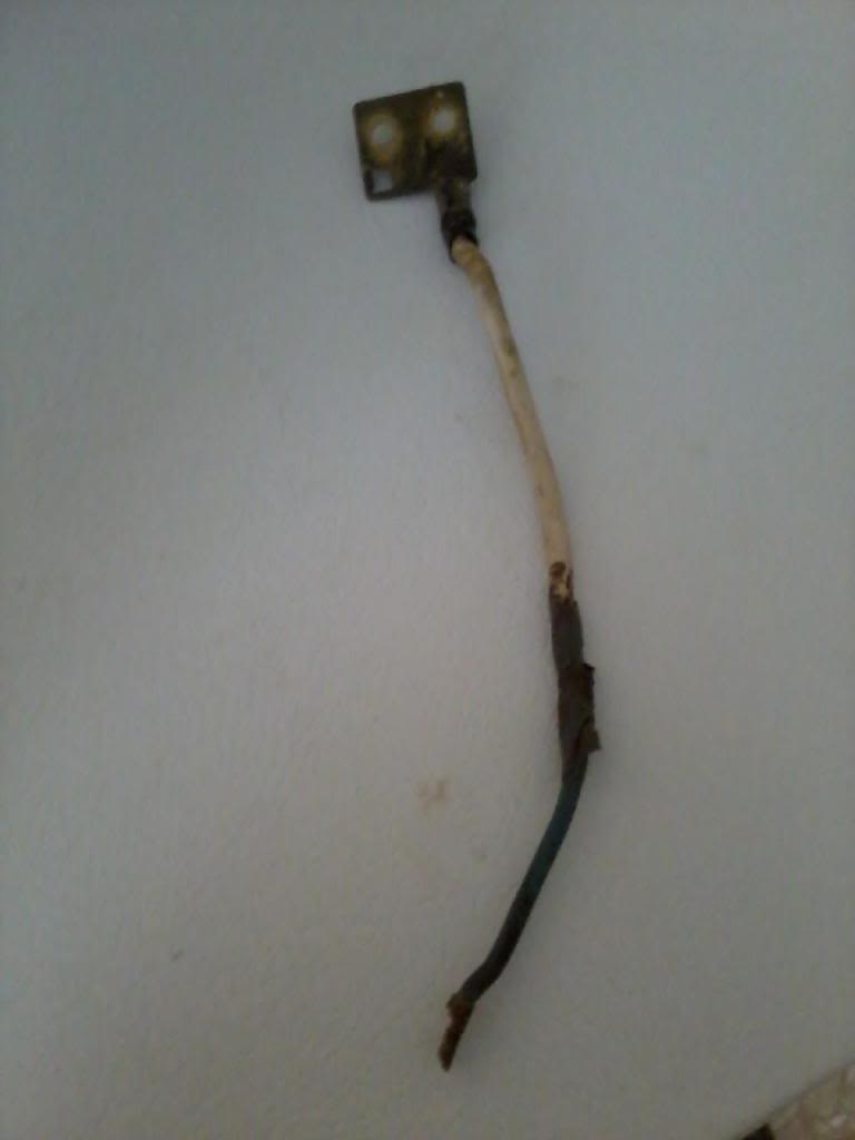

Picture of Fusible link. Disconect from positive side of battery and run a resisitance check.
Here is a picture of the Fusible Link. It is connected to 80 amp fuse and to the positive battery cable. The white part is the actual link. Took me awhile to find this out.
Here is the Fusible link attached.
Here is a better update of the Fusible Link..
When I ran into this on my 88, I thought someone had did a cheap repair job, but it is actually a factory Fusible Link. Chef helped me figure this out back then. It is crimped to the Positve pigtail coming off of your Postive Post.
All of the other fuses lift up and out. The 80 Amp you have to pry this tab to the firewall and push out the bottom.
Here it is mounted to the Fuse. It mounts behind the wires. I usually have to take a 8mm socket to the screws the first time. They can be TIGHT.
