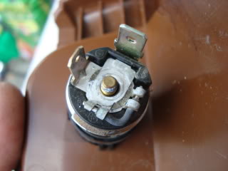

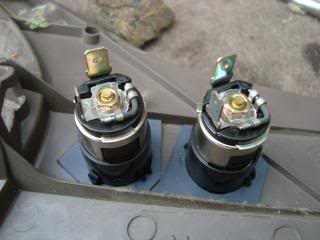

If you have your outlets you will need to disassemble them for installation. You can perform these steps at your bench or in the field. If you are going to remove these from a radio bezel proceed as follows:
Remove the wire harness from the outlet contacts. It will just pull right off with a slight bit of back and forth movement.

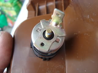

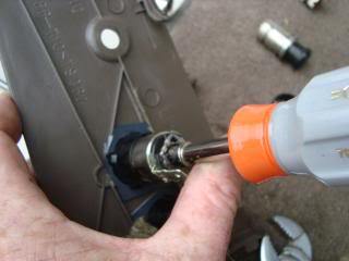

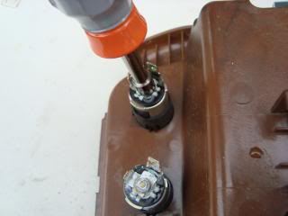

Using the 7mm nut driver, remove the center contact lock nut and lock washer. Save for reinstallation.

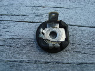

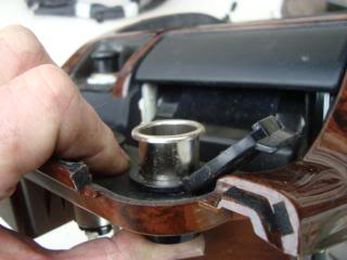

Next we will remove the outlet tube. This is the metal cylinder of the outlet and retained in position in the outlet collar by a small wedge located near the rear of the tube.

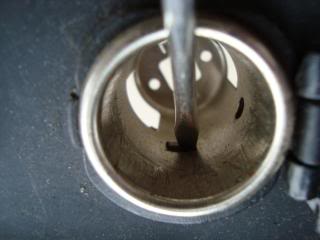

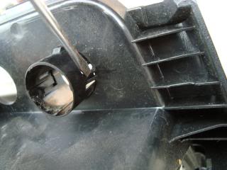

Using the small flat blade screwdriver you will need to press down the back edge of the wedge. The only potential issue here is if you are too close to the edge, when you apply pressure to the tube to retract it, the tube will be stopped by the blade so ensure you are just back from the edge enough to press it downward. This will take some pressure, but as you press down on the wedge push the tube from the back side toward you. If you feel it move just a tiny bit you may have it free enough to continue pushing the tube until it clears the collar

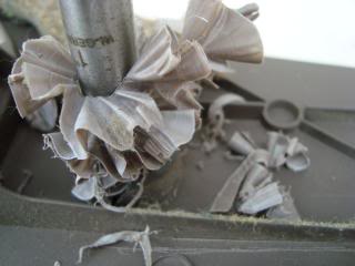

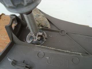

Obtain the 1” drill bit and drill.

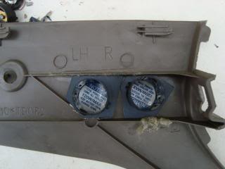

The panel has molded support ridges on the back side to give it strength. We will use these for location of our outlets. Center the drill bit about an inch from the edge and drill the first hole. This is not very thick so drill slowly until you are almost completely through.

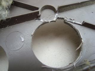

After the holes are drilled through, clean up the edges with the utility knife. Test fit the collar to orient the cap opening so they will not interfere with each other. I opted to have them so that when they closed, the cap flips would be just out of the way of each other.

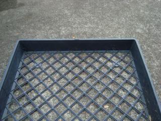

As the panel is ½ the thickness of the radio bezel, you will need to make two shims to firmly anchor the collars in position. I chose a plastic plant flat. You can get this from most any store with a nursery department (plant nursery! LOL). Find one that is pliable and not hard plastic.

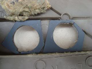

Cut off an edge strip about 4 inches long. Drill two 1 inch holes. Be very careful when you do this. I had some issues at first and was only able to start the cut and ended up finishing the holes with the utility knife. Remember to also make the alignment notch.

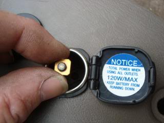

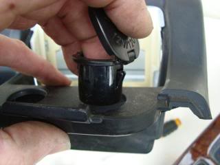

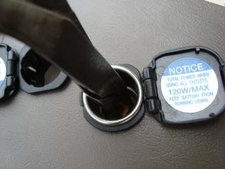

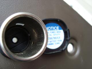

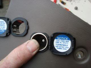

Flip open the outlet covers. Take an outlet tube and the inner outlet center piece, it is the round black piece of plastic that was in the base of the tube. Note the square base, insert the base to align the square base with the hole in the bottom of the tube.
NOTE: This is very important! Ensure the small round hole in the tube is aligned with the right side of the tube as you are looking at it. The flip cap will be right side up when you do this.
Firmly press the tube into position. Ensure that the small hole is to the right and the edge is centered on the tube cutout. Push completely in the collar until flush. Check for alignment and that the wedge is seated.

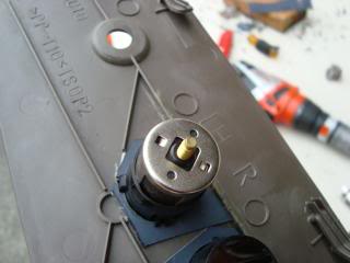

Locate the center metal pin/bolt. Drop into the tube and using a pair of needle nose pliers orient the pin into its seat.
Using your finger, hold the pin in position.

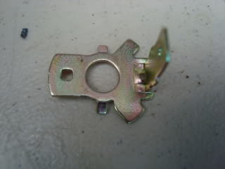

Place the small pin with the flat side of the disk towards the large pin. This will place the small pin to the left of the large pin.
Place the lock washer over the bolt and then the locking nut. Use the 7mm nut driver and firmly screw on the lock nut.

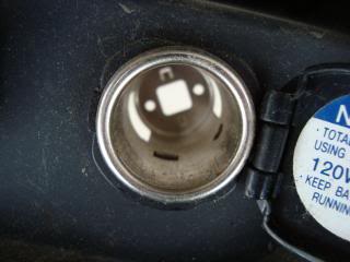

Repeat for the second outlet.

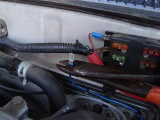

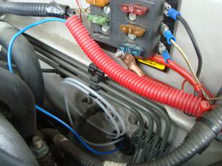

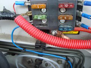

As I mentioned at the beginning, I have the Auxiliary Fuse Panel mod. If you have not done this mod, it is one of the best small projects you can possibly do and it is under $20. You will be able to provide non-ignition base power to other mods. If you do not have this mod, then you will need to locate a power source to tie into for the needed power connection. I am using the Aux Fuse Panel.
Route the 3 ft piece of 16 gauge from the engine bay through the rubber plug on the left side of the firewall. It is about 2” in diameter and comes into the cabin just above the accelerator. I inserted the end into another wire loom just to keep it out of the way and also to know about how much wire I would need to make the connection to the Aux fuse panel.
Be careful when routing this wire in the cabin. I found a route over the top along the ducting so I was able to have it out of any areas that could be a cause for entanglement. Use you own best judgment for your routing. I ended coming out at the base of the radio bezel.

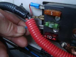

Select an empty location for the power attachment on the aux fuse panel. Strip the end and crimp the spade female connector.
Install the new connector on the corresponding fuse panel male spade connector.
Tie wrap the wire in place to keep it neat and out of the way.

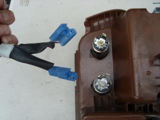

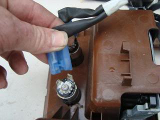

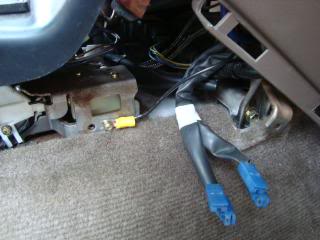

I used the OEM harness from the donor vehicle that I got the outlets from. There will be 4 wires total. Two green and white and two white and black. The green wires are the hot side. Strip the green wires ends and install into a single wire splice and crimp.
Do the same for the ground side wires. Next pull the power wire through until you have about 6-8 inches beyond the panel mounting location. Cut and strip the end. Insert this into the power splice end and crimp.
Take the black ground wire, strip one end and crimp on the split end connector. Locate a suitable ground. I chose the small brass looking phillips screw located near the shifter.
You may want to leave the entire piece of ground wire as it is, if so , strip and splice this end into the ground wire splice in the harness. Tuck the excess wire into the base of the console.

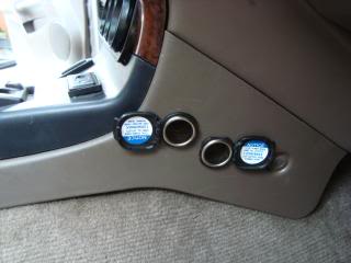

Attach the connectors to the outlet pins and install the panel. The install is basically the reverse of how we removed it. When installing the panel lock pin near the front, be sure to push the center pin of the panel lock clip out so that it is sticking out above the front side of the clip. When you install the clip in the panel, just push the entire assembly into position. Once the clip is flush against the panel just press the pin flush in the hole of the clip until it clicks.
Install a 10 amp fuse in the Aux Fuse panel and you are ready to use your new outlets.
