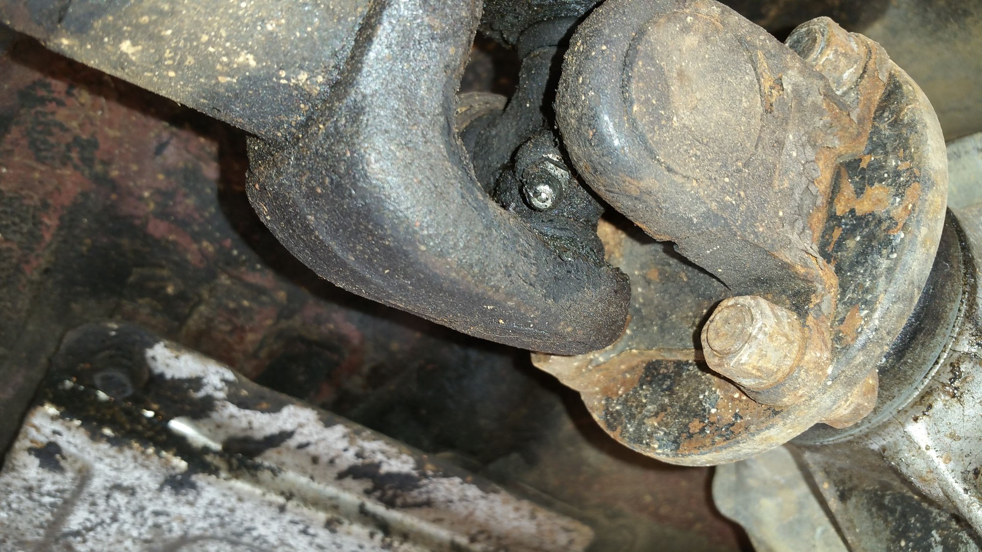

So i've tried fitting the grease gun at every angle of the driveshaft rotation to hit the zerk on the body. The grease gun simply will not fit. Did they expect is to take off the driveshaft to grease these things?
Also, places like Advance Auto Parts sell different style U-joints based on the location on the driveshaft. Would there be any reason for me to not switch to a U-joint with the zerk on the cap?
Thanks guys!
Zerk on body of u joint.
Zerk on cap of u joint.

I thought this was going to be another case of the Autozone u-joint misplaced impossible to reach zerk. But to my surprise it wasn't. That looks like an OEM style u-joint zerk location(in the center of the cross). And you should be able to use it just fine as it is. What I'm getting at is it's your gun. Not the zerk location. Because no, they do not expect you to remove the driveshaft.
But then again, it could be that the pic is misleading me due to the angle it was taken at. It looks weird for another reason, if not that, too. Like how the hell do you remove that u-joint from the slip yoke?
On the other question, no. There's no reason other than the zerk is more exposed and more easily broken off.

There is so much gunk that you cannot see the u joint cap sticking out of the slip yoke in the pic.

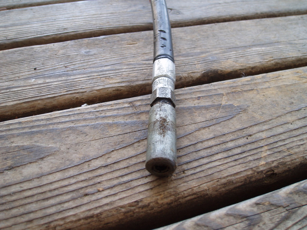

This is your typical grease gun. There is simply no way for it to reach the zerk fitting, regardless of the position of the driveshaft.

Typical in your book maybe. But I can tell from a quick 2 second glance it looks like it's got a non-typical/slightly fatter than usual tip on it.
Here's one I've got with a flexible tube. See how it's nearly the same size as the fitting it's screwed onto? It's actually just a hair skinnier than the fitting.

Answer me this though. Is that zerk screwed into the middle of the cross on an angled fitting? It kind of looks like it's more towards the corner/edge, and without an angled fitting. Which I've seen before. But isn't stock. And is probably why you're having trouble with it.
EDIT: I can tell just by the type of rubber seals it's not stock/OEM. They don't have those.

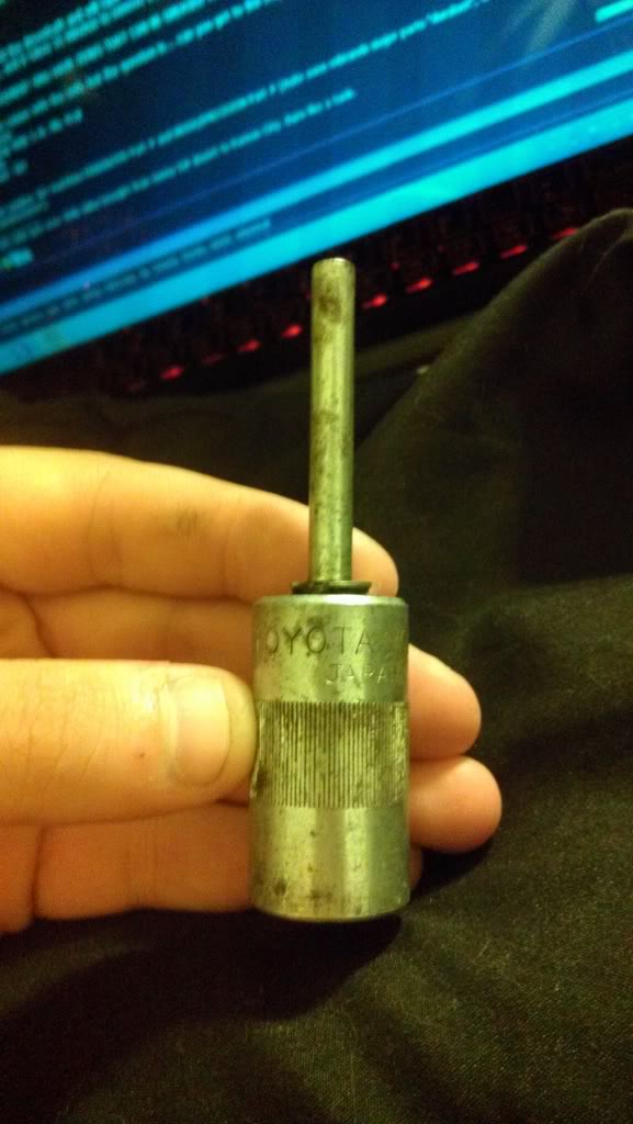

Not knowing the trucks year I am only able to tell you what I have on my 83 and 04. On the early trucks (79 to 84) a needle adapter came in the tool bag for the jack to grease the U joints. The fittings were right in the centre of the cross on a small square right angle adapter. Absolute pigs to get at and grease, you'll end up with a handful of grease for every pump that goes into the U joint. My guess is they were put there to protect them from damage. Second photo I'll guess is the Carden joint at the transfer, if so those are definitely non-factory fittings (or someone has rebuilt the joint...badly...the FSM says you cant rebuild it but any driveline shop that employs higher primates can!). The fittings should go straight out and there was a guard over the joint at least on 83's which you removed to more easily grease it. On 04 and 97 Tacos the joints were redesigned so no adapter was required. IMO looking at the pics you need the grease gun adapter for the presumably diff U joint and someone has messed with the fittings on the Carden joint at the transfer. If I can figure out how to post pics I'll do one of the adapter or at very least see if there is a Toyota part# on mine and post it. I don't see any reason you couldn't switch to a fitting on the cap, it may slightly throw out the drive shaft balance and you slight risk knocking it off.

And I don't mean to criticise, but for the sake of your U joints please clean the crap off the end of the grease gun. If you have a solid axle rig that filthy end goes right into the knuckle housing. You're better off not greasing the U joints than greasing them and getting dirt in them. When I was the Maintenance Supervisor at a foundry I fired the guy who greased the machinery because he just wouldn't clean the end of the grease gun off before greasing bearings!

If your having trouble get a needle point fitting for your grease gun
I never had any clearance issues maybe just needed to rotate the driveshaft to a different position .

This is the exact adapter you're looking for. I Googled "grease gun adapter for Toyota U joints" and found this and some other useful images.
