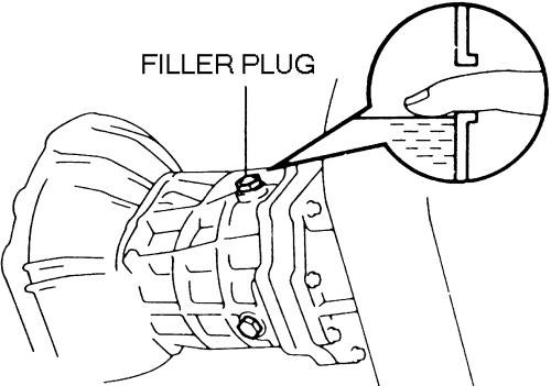

Im doing this on my wife's cell. Can you post a little info about checking the fluid level. I got no internet other than this for a few days and my truck is 2wd. Thanks guys. I appreciate the help.:

To check the fluid level you need to locate the fill plug on the side of the transmission. (Mines on the passenger side I'm 4wd though) It should be about half way up on the trans. You take the plug out and fluid should be up to the fill hole. You might have to put you pinky finger inside to see if there's fluid.
I've never been around 2wd toyotas but does the transmission tail housing have flange? Or a slip yoke?
This is a generic picture but it should help
