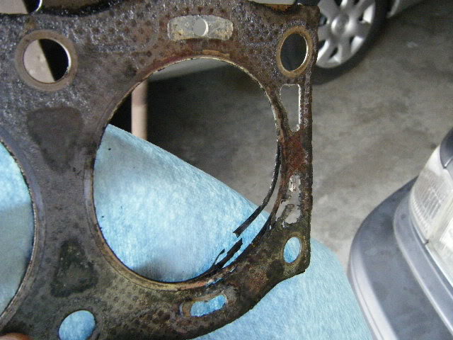

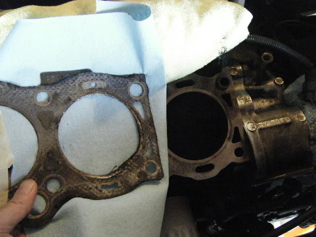

What do you guys think? here are some more photos. The area previously circled in green is not damaged, it must have been the angle of the camera and light. I took out a magnifying glass and went over with a razor...smooth. I think the old gasket shows also that there wasn't a leak there.
This is my first head gasket change, so I know nothing about this...At the bottom is the new one, a Fel-Pro MLS has a red (raised) bead of some sort also.

I think 5 things:
1. You/me/us are right. There was a leak there, coolant and combustion/compression.
2. That's a properly blown head gasket. Kudos for not trying to guess if you have a blown head gasket, as is questioned on a daily basis around here, and going ahead and waiting untill it went. At which point, by the looks of it, it was pretty easy to tell with all the white fog coming out the tailpaipe. And the engine making that "blap,blap,blap,blap,blap" sound that goes along with compression loss on one or more cylinders. I can't stand all the "is this a blown head gasket?" threads. When it blows, you'll know.
3. The area in green not being corroded doesn't suprise me. I just couldn't tell for sure. So to correct my previous statement, it looks like the majority of the problem was at the coolant passage just below it(in the pic).
4. You're going to catch some flak for the Fel-Pro gasket. Just not from me. It'll probably work just fine, if you do a proper installation of it.
5. Pic a sealant and get to work!

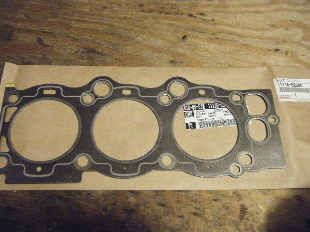

Can someone tell me if these Toyota OEM gaskets are MLS ones? After doing some reading I see that everyone recommends the OEM ones, so I held off from installing my Fel-Pros. I got these today and they look just like the ones I pulled off and are real flimsy compared to the Fel-Pro's I have. The Fel Pros are pretty sturdy and beefy feeling, and the OEM's feel light and flimsy.
Are these not the latest and greatest ones?
