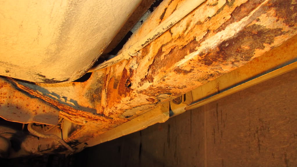

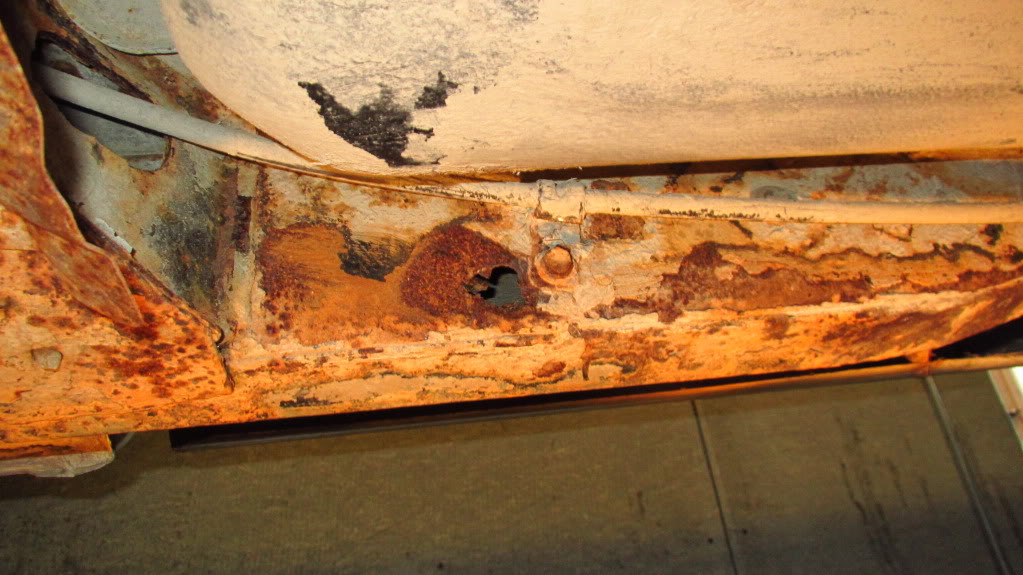

Anyways, i have an old 1992 Volkswagen Taro 2WD (same as hilux) that was given to me by my father-in-law. It's supposed to be my girlfriend's car for when she turns 18, but it turned out the frame was all rusted through.

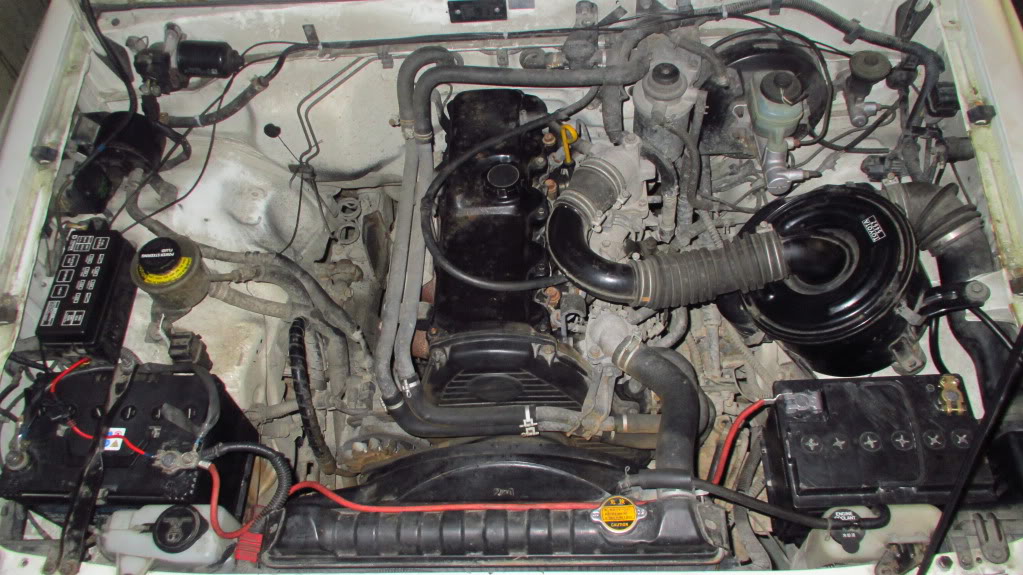

And since it's so hard to get hold of a 2WD frame i thought i might be better off just getting a 4x4 and replacing the engine with the engine from my 2WD (It's only done 80K miles) since it's in excellent condition.
So i'm wondering what my options are..
Can i get a 4x4 and just drop the engine & cab onto the 4x4 frame?
I know the engine will be almosta direct fit, but does the 2WD cab fit on the 4x4 frame?
Or will i have clearance issues?
Thanks in advance

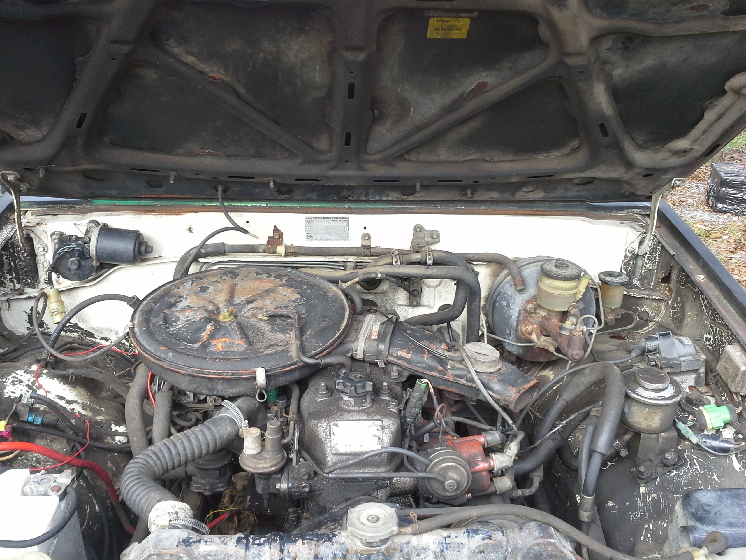

The under the hood shot dont look nothing like the under the hood shot of my yota but ive seen jeep bodys on toyota frames (and Nissan and Isuzu and ford on Toyota frames ) so id imagine you could force it to fit edit the frame dosent look all that bad in the pics you can allways weld plates over any holes

I thought the 2.4D (2L engine) was very common.. Oh well, it might be more common over here in Norway than in the US.
I know it might not look that bad but the frame is really rusted almost all the way through at some places, and you can rip off big parts of what used to be the frame..
I'm sure it's possible to weld it, but we've got very strict rules here in Norway when it comes to modifying/fixing your car your self..

Bro i think your mistaken this is a Toyota 2.4l/22r but ill belive you on the rust
Attached Thumbnails Taro/Hilux 2WD Cab on 4x4 frame?-20130118_104616.jpg

I'm 100% sure my engine is the 2.4L Diesel. It says 2.4D on the front wings, it has to glow before you can start the engine because it has glowplugs, and most important of all.. It wouldn't run if it was the 22RE, because i've poured many a gallon of Diesel fuel into the tank

BINGO!! We have a winner..Diesel...an engine that we should have but Toyota in their finite wisdom decided otherwise.

Frame swap will be a bit of work, swapping engines easier but if you drop the tank you would probably have the room to fix the frame with some plate. A lot of that looks to be scaley..scrape and hammer to see what is left before you turn a wrench
Finally!
Thanks for the reply Unless i failed to mention it, I live in Norway. Almost all Hilux's came with the 2.4L Diesel engine (2L or 2LT), only a few chose the gas version.
You're completely right. It's very cold in the winter, and yes, it's spent most of it's life close to the ocean.
Also, the authorities are such assholes that they use salt to clear the ice on the roads.. Free rust for everyone!
Plus the fact that the truck had been sitting outside for 3 years. Started right up though! (with a new battery)
I actually think the engine swap would be easier, yes. I wanna get a 4x4 and just swap the engines. The engine would drop straight in with a few small modifications
