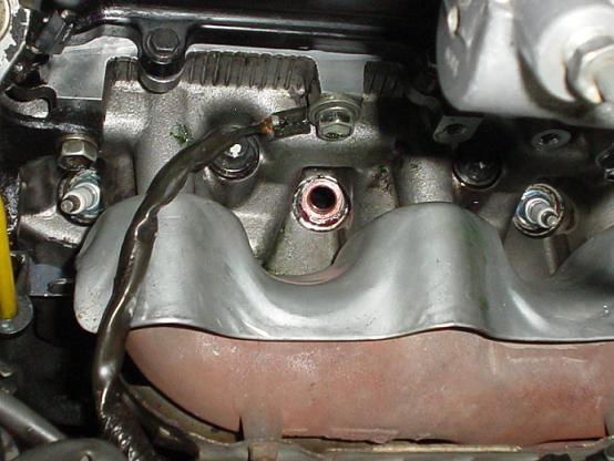

Old Feb 14, 2007 | 09:16 PM
Ebin's Avatar
Joined: Sep 2006
Posts: 117
I think some people missed this was a repair after a repair of a spark plug hole. What I ended up using was a "Big-Sert Kit # 5141" repair with a 16.8mm (insert # 51407) made by Time-Sert. This was a hard to find part. After alot of dickin around by alot of suppliers I found a super reliable company. They actually had the part in stock and actually got it to me next day. Super great guys to deal with. If anyone needs this similar fix, talk to Ralph at Bel-Metric @ 978-649-6201. Or, you can email me......kit still has 4 inserts left..LOL. It'll run you about $200.00.
