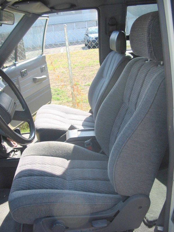

Driver side will fit with a little oval-ing of the bolt holes. So will the passenger side - but if you want to keep the tilt/auto-sliding feature, you'll have to swap the brackets from the 85 to the 95. Undo the hog rings and pull back the seat covers just enough to remove all the bolts. Everything lines up but you have to space out the bracket on the 95 seats because its slightly narrower.
The rear seats are a different story:
https://www.yotatech.com/forums/f116...t-swap-118423/

Swap these brackets:
