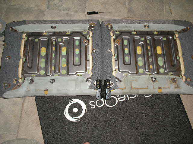

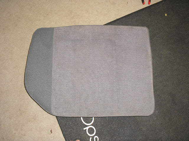

Here's a pic of the new seat bottom:Name:  P6170392.jpg

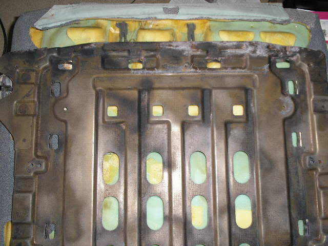

Take the trim off your old seat cushion and you will see this:
Its just a frame with a cushion that has a built in frame connected to it. The upholstery is wrapped and connected with hog nose clips or staples. Get some sharp snips or just stick your needle nose pliers in and open them to pry the clips open. This is a pain in the ass at first, but it gets easier.

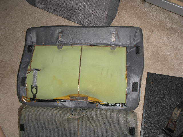

Here is what the back of the new seats look like:Name:  P6170398.jpg

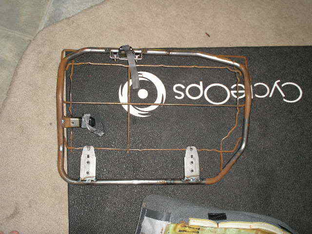

I went one cushion at a time, and since my frames were rusty, I treated them before putting the new cushions on.

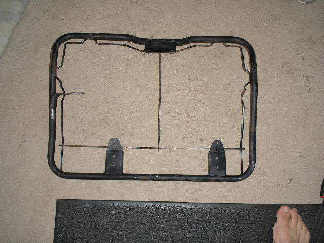

Here's what the 95's frame looked like:Name:  P6170391.jpg
And here is my old frame after I treated them.
You will notice that they are a litte different. The place for the "feet" of your bottom cushions do not line up. That's why I used my old frame. The other way to go would be to cut out and weld the feet bracket spots in the needed llocation, but I am not a welder. If you ever want to know how to do something easy, ask the Lazy man....

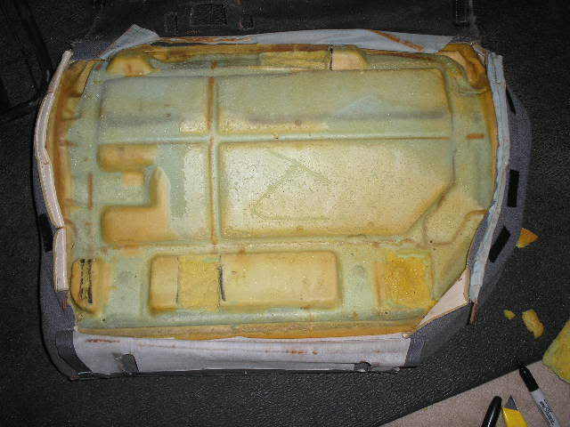

I took the new cushion assembly and cut the foam to match my old frame:
Then I pulled the cover tight and used zip ties to connect it to my old frame.

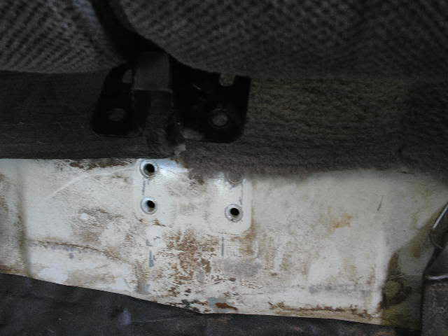

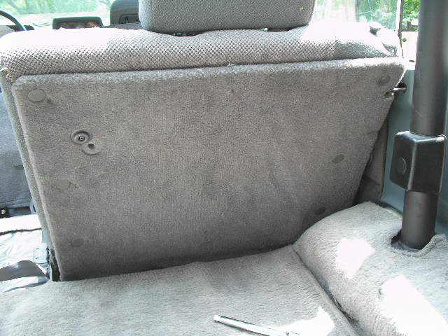

I thought the backs would just bolt in, but I was wrong. They work the same, but I locked them in where the striker is, and this is how far off they are from bolting in:Name:  P6170393.jpg

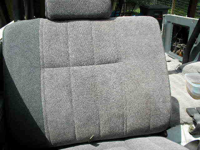

Here's the finished product:
It wasn't hard, just time consuming, but I think it was worth it. If you need seats and you don't have ones currently, you might be able to weld the brackets to the right spots, but that was out of my league to do that.
I still have the unused stuff if anybody for some strange reason wants them. Otherwise, they are going in the trash this week.
Hope this helps...
