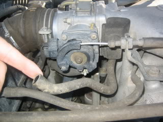

hey, i just picked up 2 cans of seafoam and am gonna do the treatment today along with a good clean up of my engine bay and rest of the truck...
i really want to be sure i get this in the right hose, im aiming for the PCV line, mine is kinda dry rotted so ill be replacing that while im at it, but anyways all the other pics i could find are now little red X's so can someone confirm that this is the right line?
thanks everyone, and just to make sure i have the instructions right, i pour about 1/3rd a can in VERY slowly while its running, and then after its done smoking pour another 1/3rd can in slowly and have a friend turn the truck off after it all goes in?

Originally Posted by RunnerUp
Yeup... that's the one. And pour it into the end that you show disconnected.
There are a couple of ways to do it, and that way is fine. The key is to let it sit for _a while_ (a couple of hours or even overnight) after turning it off.

okay.... so just for everyone's future reference, this is UBER SCARY to do the first time...
pretty much right after i pulled the PCV i didnt cover it with my thumb so my motor stalled, after that happened i knew i couldnt let it suck up too much air so i kept my measuring cup handing to pour it into the hose immediatly, and just remember that a steady flow is necessary otherwise you will stall your motor out!
lots of smoke came out after i let it sit for like 5 minutes, ive just let another batch sit for about an hour and am gonna go drive around... then im gonna put one last batch in and let it sit over night, after the first time i noticed it immediately idled better and it didnt tick as loudly. i cant wait to see how much crap comes out tomorrow morning, thanks for the help midiwall!
