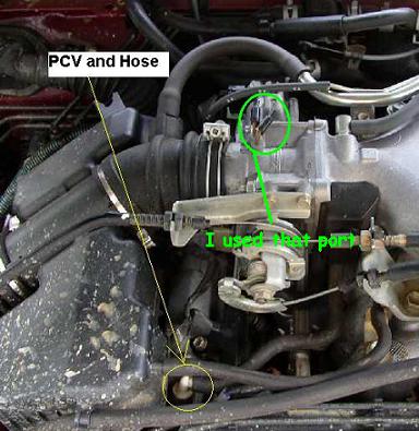

On the 3.0 I used what is Highlighted in green... I know its on a 3.4, but the 3.0 uses what looks like the same intake just on the oppsite side.
Attached Thumbnails Seafoam Injector / Intake Cleaner = GOOD STUFF-highlighted3-4-intake2.jpg
