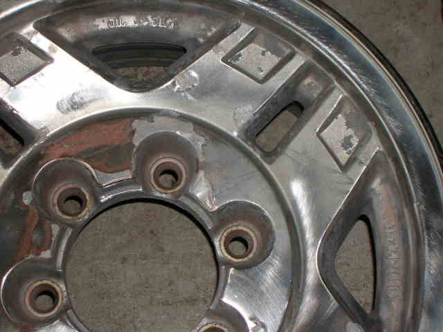

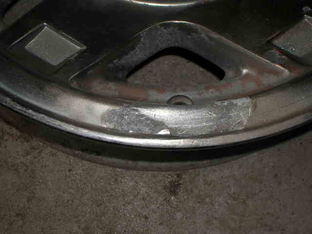

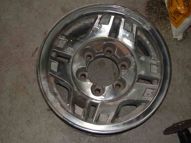

Probably should have guessed a photo request was not long in coming...LOL
Attached Thumbnails Refinishing SR5 Alloy/Chrome rims-dscn0291.jpg   Refinishing SR5 Alloy/Chrome rims-dscn0292.jpg   Refinishing SR5 Alloy/Chrome rims-dscn0294.jpg

I see the red color. It appears that it is only in the wheel recesses or is it under all portions of the wheel? I don't know for sure, and correct me if I am wrong, but the the recesses have a rough finish compared to the outer portions being realtively smooth? That is the way it was with the spoked alloys I refinished. I never touched the recessed portions, and only removed the clear coat from the outer portion.
I can't really tell that your wheel has been chromed-not that I am an expert on the matter. I have seen some OEM wheels that had been chromed for sale on eBay and they are very shiney. Also, it looks like some clear coat is still on your wheel?

I read that - that's what got me going this way to start with! I figured the bed blasting would have removed any clear coating pretty quickly. Then I figured if it was paint, the Scotchbrite disc would have cut right through it. It took the belt sander to expose the copper color around the lugnuts.
Yeah, the pictures aren't all that great. They are actually pretty shiny. The area between the beads (where the air is) is VERY shiny. In the second pic, you can see the copper showing through on the flat area around the lugnuts. The area immediately around the lug nut at the top is the actual aluminum (and lower than the "chromed" area). In the third pic, you can see where the "chrome" has come off at the bead (about 1:00)
Would it be worth it to try paint remover? Any recommendations? (and where to get it - have Advance, AutoZone, and NAPA pretty close)
