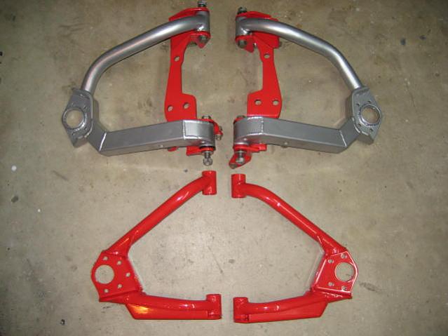

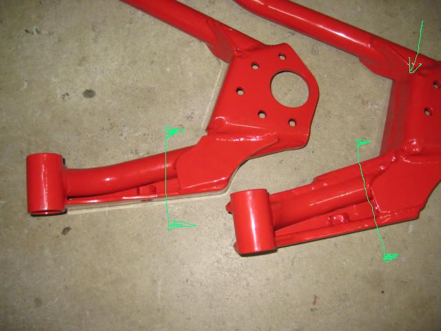

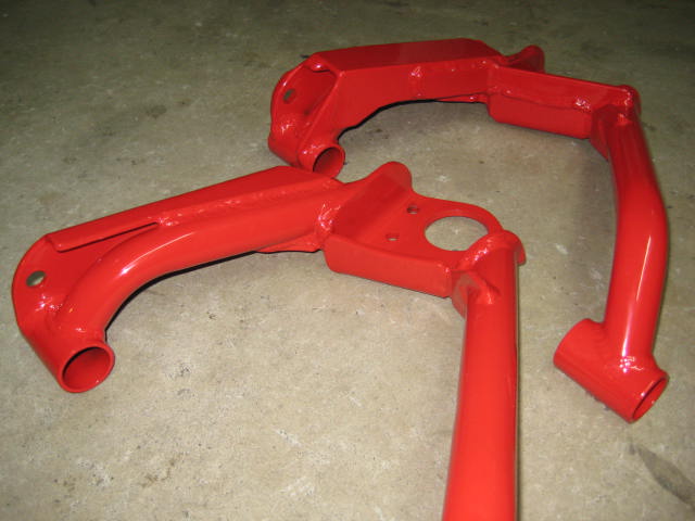

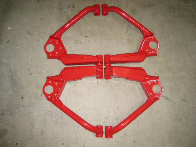

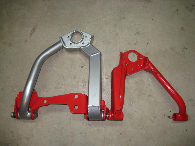

Here are the re-inforced Rancho UCAs next to some unmodified. Yes I have a set of the original and a set of re-inforced arms see the differences! I thought about selling them but will probably just keep them in the Blazeland Museum for posterity.

Couldn't tell you exactly what I have.
Maybe Raybicon can answer? he's the one I bought it from.
the reinforced ones are only a little bit wider... does it honestly help that much?
Maybe Raybicon can answer? he's the one I bought it from. the reinforced ones are only a little bit wider... does it honestly help that much?

The centerlink and the pivot brackets are worth something. To reproduce either would be difficult and costly. I made a Rancho Gen II long arm kit that has potential for 2WD desert running. It can cycle 13"-14" of travel but as soon as you want 4WD you have to limit it back to 12"

Hmm Interesting... I took a look at the arms I have currently, Seems to have no stress marks, bends, cracks or anything in that subjected area, or on any other part of the A-Arms.
