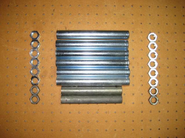

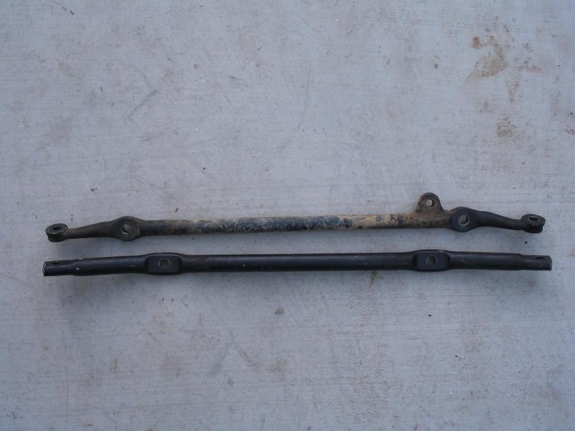

Old Jan 25, 2010 | 09:02 PM
  #60
BlazeN8's Avatar
Posts: 977
From: Southern California
Originally Posted by MaK92-4RnR
whats the manual include? just the parts list? or a "how to?" I haven't heard of anyone needing to use the centerlink?
The manual is 15 pages long, the first page I attached is the parts list. Tell me you didn't buy an incomplete kit from a design that was discontinued in the 1990s!
Of course there was a centerlink and longer tie rod adjusting sleeves. The ones I have machined for the Blazeland LT are slightly longer.
Attached Thumbnails Rancho IFS lift kit and Aisin Manual Hubs!-rancho_centerlink.jpg   Rancho IFS lift kit and Aisin Manual Hubs!-img_1195.jpg
