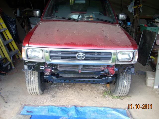

I did some Por15 coating today and did some last week on the suspension and the frame forward towards bumper.
For what it costs it should be renamed rich15 :}LOL
Buying just a small can is $30 bucks will make you por2 :}LOL
It is the best, so I bought some!!!!
