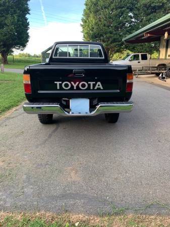

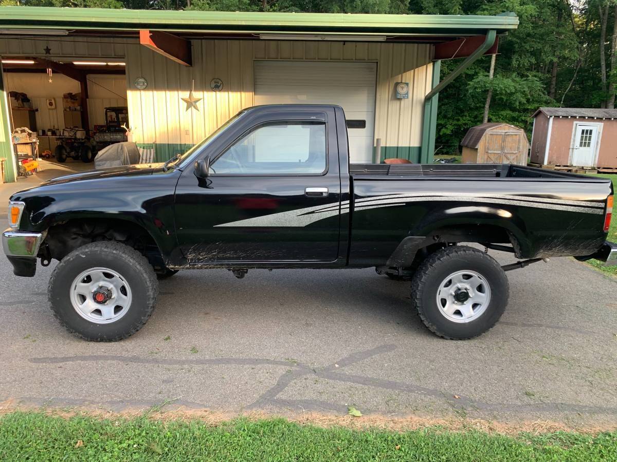

Long time lurker, first time poster. Found this gem on my local craigslist the other day. Test drove it yesterday. Runs well, super clean body. New parts littered around. 180k miles. No rust on the body, mint interior. Frame has a 6” long rusty crack running in front of the passenger side lead spring. Other than that it’s a solid truck. Minor rust on the frame scattered around. Would you all pay $4700 for this?
Im on the fence of whether or not it’s a good deal, and if it IS a good deal, would the frame fix be worth it?

Kind of depends on what area you live in. I'd have a hard time paying $4700 for something with a cracked frame. Also the bench seat is torn, so the interior is not mint.

I ended up buying it for $4300. Little love here and there, she’ll be alright.
True, but very little staining. Dash is in great condition too!
