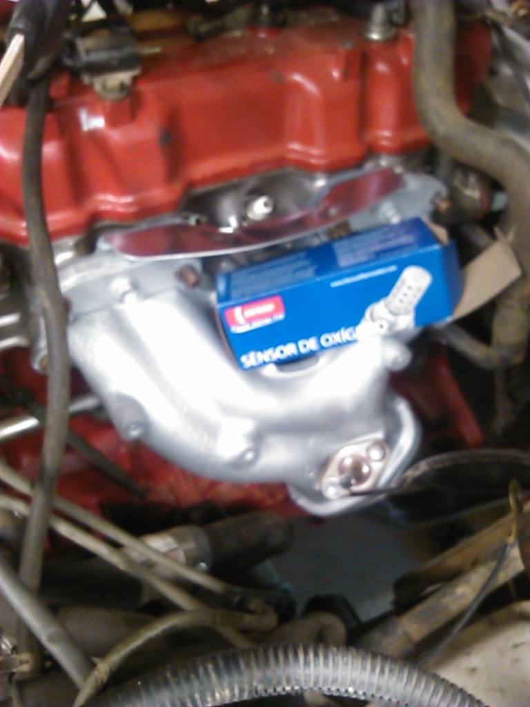

I worked on a California Emissions truck that had an O2 sensor on it as well. I was surprised to see it had one and I know the truck was in original form. Being and 84, it should be the single wire one in the exhaust manifold. I too am not sure how an O2 sensor can really work on a carbed truck. There is a little mini computer in the passenger kick panel that controls it. It is only on California Emissions Models from my experience.
Toyota did not use the 4 wire sensor until 88 and then it was in the exhaust pipe near the transfer case area. Being a Dolphin, I cant see why it would be any different then any truck unless yours is just something really different. Under the hood on the passenger side, there is a label ( if it is still on there) telling which truck you have. It will be Cali Emissions or Fed Emissions.
Stay away from Bosch and Universal sensors. They are great for other trucks but not Toyota.
Here is the one I am sure you need. http://www.sparkplugs.com/Automotive-Sensors-c239.aspx DEN234-1056
Here is where you should have the sensor for an 84.

I have also never seen an '84 Toyota pickup with a downstream O2 sensor. I have seen the RV manufacturers extend the exhaust, frames, drive shafts, etc, but not the electronic controls of the engine. If anything, I believe it could have less emission controls because it is in a heavier duty weight class.
The O2 sensor should be on the manifold, as the picture by Terrys87 shows. In my experiences working on these trucks, including some RVs, O2 sensors in those years were only on California smog models, where the signal are processed by the computer and the mixture is controlled by a device called an EBCV. The EBCV controls the mixture in the carb by a small amount. I think it is able to release some of the pressure drawn by the venturi, but I am not exactly sure. I would actually like to know if anyone knows for sure. There is also an EACV, also controlled by the O2 sensor and computer, that lets air into the exhaust so the catalyst can work optimally.
