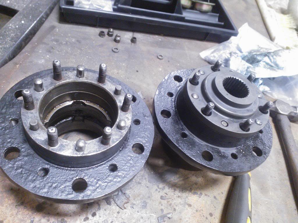

This. However.. now that my truck never sees pavement any more, I opted for flanges..
I loved the warn hubs on my 87, very easy to turn and no cone washers! But that is also their weak spot, the cone washer add strength where a straight stud might sheer off under heavy loads.

I could understand the strength thing if all one did is drop the vehicle off of two foot or taller rocks all day long.
Besides it would be simple to machine the Warn Hub Body to use cone washers.
