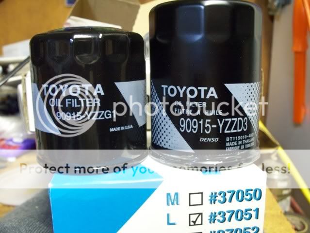

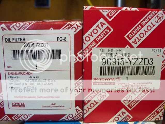

I just figured I'd post some comparison pictures of 2 Toyota oil filters.
The filter on the left is for a 3.0 and a 3.4. The one on the right is for the 4.7 V8.
The larger one will easily fit on the 3.0 and 3.4 and it doesn't cost anymore than the smaller one.

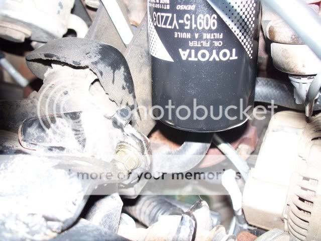

Here's a picture of the larger one on my 3.4 swapped daily driver.

yeah, toyota has 3 sizes they use for MOST of their motors. the 4cyl size, the 6cyl size, and 8cyl size.
I've been using those V8 filters on my Supra for a while now. They also fit on 22R motors if you feel like it.

Haha, Denso filters made in the USA and Thailand....
So the 4.7L filter will fit in place of a 3vze stock filter??

The real deal Japan filters are like $12-$20+. They sell them as TRD filters. But even then you have to know what part numbers to ask for to get the Japan made filters. Most of the high dollar TRD filters are made in the USA. Probably by FRAM and the other filter company's.

She fits, pretty tight!!
