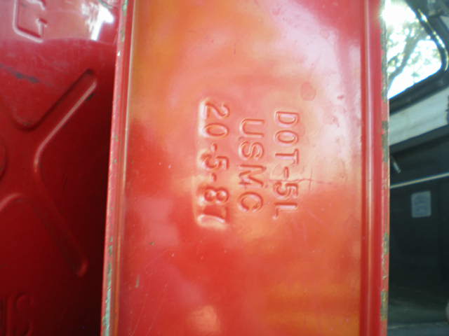

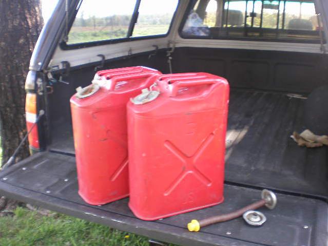

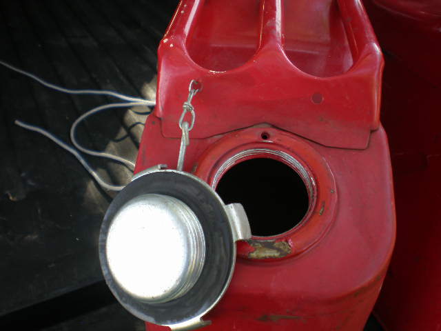

So the other day I can across these two jerry cans for sale and I got them both for $5 each and a spout. They are in great shape, no rust at all and about a 5 gallon capacity. They have screw on caps with a rubber seal on the cap. One of them however is missing the black rubber seal. So I put some fuel in one today and saw when I got home that a little fuel had made its way around the seal. My question is where do you think I could get some new rubber seals. Maybe in the plumbing section at home depot or something or do they need some special seals? Also the one with the seal on it has some paint that has chipped at the bottom of the spout that you can see in the pics, I have a feeling that made the surface for the seal a little uneven and didn't help the leak situation. What kind of paint would you use to fix that? Anyways while we are on the subject what else can you tell me about this type of can? I see that they say USMC on the bottom so I am ''guessing" they are military cans. I have seen that a lot o f guys like the NATO type cans why is that? Are there advantages and disadvantages to each type? Lots of questions I know any info would you have would be great. Thanks.

i have two jerry can i bring with me everywhere. i painted mine black with whatever i had laying around. mine is also missing a seal. they need a flat washer i looked at home depot and couldnt find anything that worked. if you find something let me know. the only other thing i know is that they are tough and everybody that wheels has one... thats why i bought mine lol

True Value or Ace Hardware may have rebuild kits for those.

what about buying a gas tank cap and pulling off the rubber seal for those?

http://www.jeepforum.com/forum/f8/ne...askets-597864/ here is a little discussion over this topic. I know I know!..... it's a jeep forum, Don't hate, I just found it through a search engine. Seems like some of them have resorted to cutting their own out of some sort of thick fuel resistant rubber sheets. Any thoughts?

as long as its a tight fit it'll work.

For real though, I found a gasket at a local Lowe's that worked for mine.

You wouldn't want to wrench it on. After you've gosselled the hell out of it and it's been in the sun you'll want it to vent if it has too.

to loosen mine i use a long screw driver and put it across the prongs on the cap. works great for me

Update so, I FOUND SOME! many of them sort of. I resorted to having some made. I found that the ones at the military surplus store weren't really that high quality of a rubber, a little stiff and would eventually fail again probably sooner than I wanted them to. So I now have quite a few for and they are for sale! They are made of fuel resistant nitrile rubber and are slightly softer than the military ones. I am selling them for $3 a piece plus the shipping which shouldn't be over a dollar more. They are the exact shape as the original seal would be just made much much better, remember the are for the screw cap cans. The price could get better if you buy quite a few. Ill probably make an add soon in the market place so keep your eyes open. Feel free to PM me if you would like to buy some. I just put them on my cans and tightened them down and turned the can upside down with NO leaks to speak of! Awesome.

I also found out that you want to use only enamel paint on these cans. It will hold up to the fuel exposure much better. I tried regular spray paint a while back on the spouts and it came right off.
