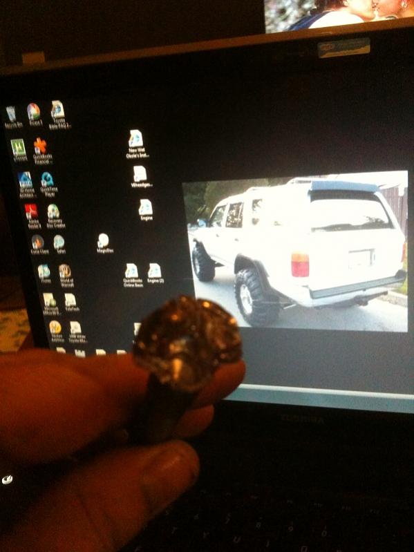

I win. I got it.
Now.... I have a snapon socket set just for these headbolt types. Background story first.
A few years ago I was doing some headgaskets on a 1997 Mustang with a 4.6. I was busting the headbolts loose and then it happened. I let the ratchet slip, resulting in me punching the opposing head like a heavywieght boxer.
I had a serious cut across three fingers.between the first and second knuckles....you know where it really hurts.
So...I was busting these head bolts loose and at the last second on the last bolt...i had a flashback of bloody knuckles... i let the breaker bar kinda tilt and rounded the mofo off. I geeked it. At least I didnt punch the head again.
So between bolt outs...a drill...some extractors...I got it.
Worked it and worked it...then it just spun out...like it wasnt even tight.
Attached Thumbnails I've done it now....rounded off head bolt. Whoops!!-bolt.jpg
